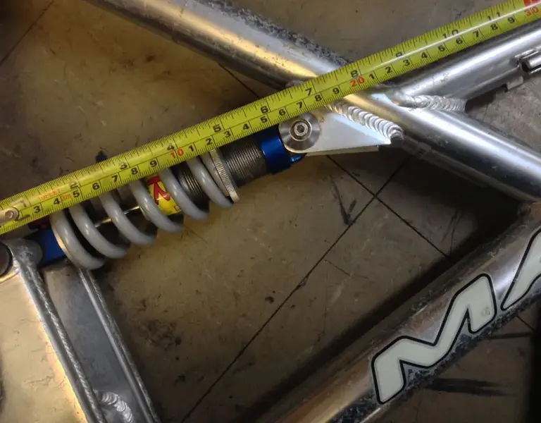

What length was your rear shock? I'm watching a couple on eGay at the moment, so fingers crossed (they are 165mm).
Chain length should be fine as it is, the chain device i use is a blackspire stinger, theyre easy to get hold of
My float shock was 165mm yes, but i had a different bike to you so you should remove your shock and measure between the eyeholes to be sure. Come to think of it i had a fox vanilla shock on my santa cruz heckler. It was a modern coil shock with a preload adjuster which still looked kinda retro but was a brilliant shock as well. I think id recommend that one over the float

Cool thanks for the info. My Marin is in Melbourne at the moment, and im in the UK for a while so I was hoping to take one back with me. I thought I'd measured it at 185mm when I took it off but now Im not so sure, as most people are saying 165. Maybe I'll get one of each! :D
Theres a local bike charity run organisation ive been involved with and the last time i went in there they had one of these frames hanging up in the workshop (all coroded and looking sorry for itself)
I'll go there today and if the marin is still there i will measure the shock for you
Sean :)
