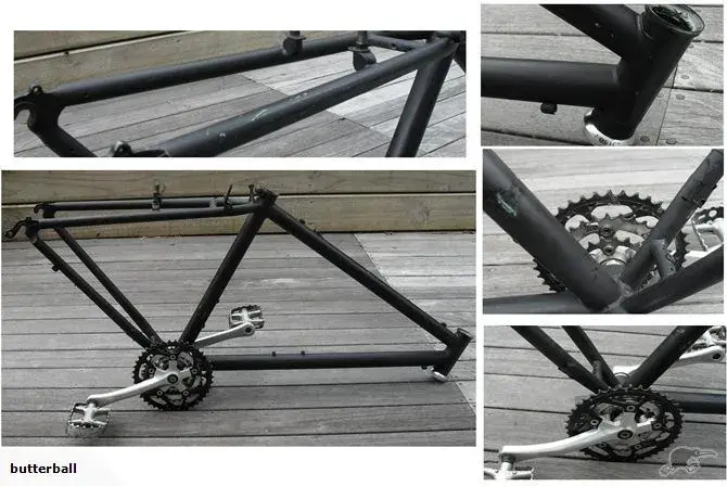

I bought a frame on an auction site over here in NZ, it was said to be a Team Marin dating to '91-'92.
So I get it home and as always try to get the BB out . . . . 2 years later its out, this frame was nearly thrown away about 4 times, for some reason I kept it.
I used a longer pipe than usual and a shallower tool (Park BBT-32) and the adjuster cup(non drive side fixed cup actually) turned I could not believe my eyes :shock:
So I have a 110MM UN-55 in there now after running the BB tap through the threads to clean more than anything else.
XT cranks you see in photo will go back on and XT Mechs and brakes shifters etc off of a rusty Stumpjumper Comp will go on(Stumpy will convert to drop bars) Stumpy will also give over XT 32 spoke front hub and I have a match in 36 hole for the rear.
Marin will probably run rigid for a while, I have a set of Rockstars off of a '92 Muirwoods with a stuck BB, I may then later go to Rockshox XC32. If I do this I will paint frame in Neon Green fully, as you see frame has been sprayed in Matt Black so original will cost that little bit more - yet if I take what was a original colour from the Team and go whole frame I think it will look real good.
