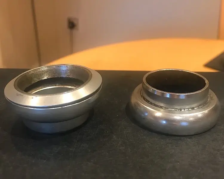

Hey thanks both. I just want something that will fit it. Too be honest the only headset I've fit is on my modern bike and it's a press fit one with sealed bearings. I removed the forks to service them and was confronted with a bunch of exposed ball bearings in a bad way. I dont mind spending a bit on something half decent say up to £50 I'm just not sure what type of headset I'm looking for or the actual size i need. It's a standard oldschool straight steerer fork btw. Thanks again
I’ve got a picture of the original headset which I removed from my 1998 Mount Vision which I imagine will be identical. I’ll try and post a picture here later on. Hope that helps.
Here’s a picture of the headset I removed from my 98 Mount Vision. I replaced mine with a lovely black Hope effort.
Anyhoo, the top cup still has ‘Aheadset’ on it, the caged bearings were shot so they’re long gone.
