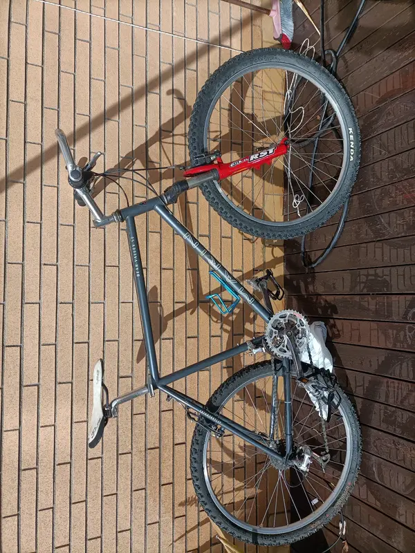

Hi all, I have a 1995 Marin Bear Valley E (XL), equipped with a suspension fork...I want to replace it with a non suspension fork...does anyone know the A-C length of the original rigid fork? Unfortunately I will need to move to a-head as finding a threaded fork with a suitable steering tube length is unlikely.,..

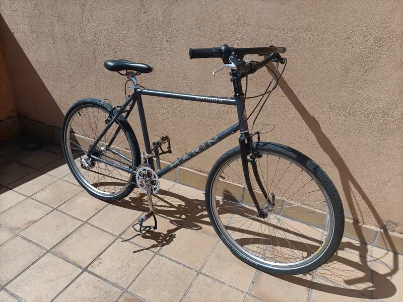

That is why I love Retrobike! Thanks a lot for the response! I have the longer head tube version indeed (it is the 20" frame)..I have a surly LHT fork threadless with 39.5 cm A-C length. It will do the job....I won t be able to keep the beautiful Marin quillstem though.....but get rid of the ugly and heavy red RST suspension fork. I won t go shopping for more stuff....my better half instructed me to stop stuffing the house with bikes and parts...have to use what I have.
Thank you @Tootyred ! Before and now with Surly A-C 395 fork. Thanks for your help, it was worth it!
