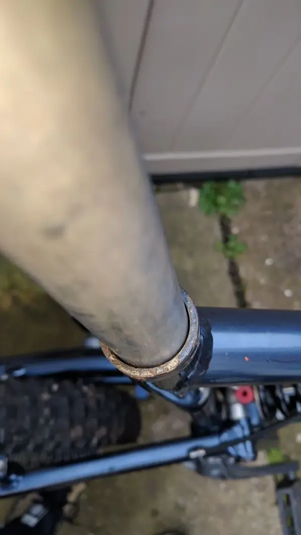

as per title anybody know? It looks to me the seatpost in it is a bit small. For reference its a 26.0.
Thanks!!!

And to the other post I would be surprised if it was 30.0, I have one and its nowhere near going in, unless its been bent in so much!
Yes, have to admit it does look a bit of a leap from 26 to 30mm!
Might be worth thoroughly cleaning the inside of the seat tube out though, and making sure the top of the seat tube hasn't ovalised a bit....?
same as my 2000 Muirwoods. Was going to buy a nice new 27.2 seatpost then realised it was a 27.0 :facepalm:
my old shoreline trail was a 27.0 as well around the same year. Think that was a fairly standard size for them around that time.
If your seat post clamp or front mech are 31.8mm you can be pretty sure 27.0 will be right. 27.2 is a common size ask around friends/colleagues and try one, if you can only get it in the top inch or so again you will know.
