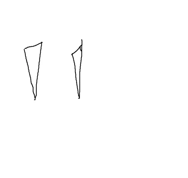

Revised my estimate looks like a 97' with newer parts. As to your headset woes agree it is probably bearings, all that extra length on the steerer probably isn't helping though. Personally I would put a higher rise stem on and a pair of riser bars to get the same effect....

But that would change nothing, wouldn't it? If the total distance is the same, however achieved, it stresses the bearing the same way.
But I agree, the handlebar is now very high. The previous guy must have been taller than me, or wanted to keep his back upright.
I will just get rid of the extender. Less weight to carry around :lol:
