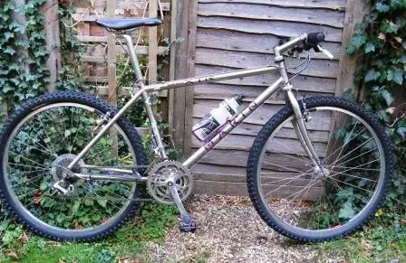

Might as well show off my Team Issue, its 15.5 c to c which equates to a 17in c to top in most other manufacturers
Next size up is 17.5in c to c which I suspect would do you or maybe even the smaller one if you like a fair bit of post out.
They have long top tubes, so reach shouldn't be a problem especially with the longer stems that were fashionable in the early 90's

Thanks for that. Do Marins come up bigger than others? Unless I put dirt drop bars on which probably won't happen the top tube will be plenty for me.
Not sure they come up bigger, just measure c to c same as GT do
Big difference between say a 19in Marin and a 19in Stumpjumper, but only because of the measuring system although as I mentioned they do have a long top tube as well
If you are of normal build reckon the 17.5 would be fine for a six footer, I tend to go for a smaller size due to the length (or lack of ) of leg
