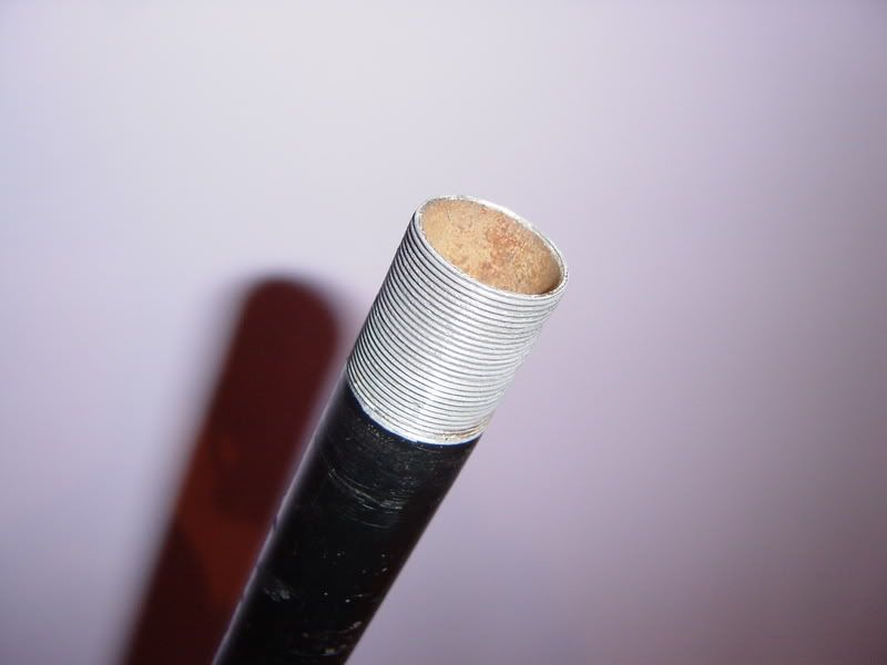

Anyhow, the fork threader turned up :
And this is how the forks looked after the initial putty coating and running a old headset up and down :
I will post some finished pictures when done but the threads are looking better still - you cant even pick out where the groove was for the tab washer.

I have finished the fork threads and the borrowed tool has been returned – I am very happy with how they look but time will tell how they last … :?

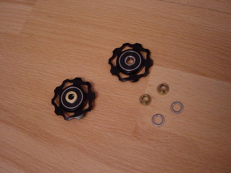

The Bullseye jockey wheels have had the bearings pressed / loctited back in.

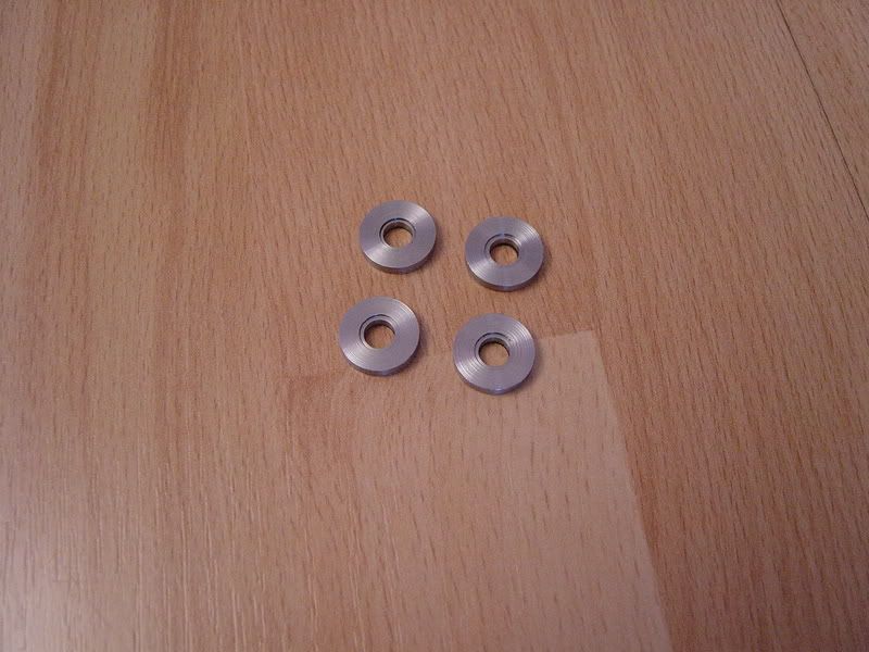

I never noticed when I was younger but the cantilevers had a noticeable amount of fore and aft play on the mounts. I am not so keen on this so I have made up some stainless recessed washers that fit / work perfectly. I tried ally at first but it was to soft and deformed when the bolts were tightened :(

The canti washers as made (The side facing up faces inwards when fitted) :
And then polished / fitted :
