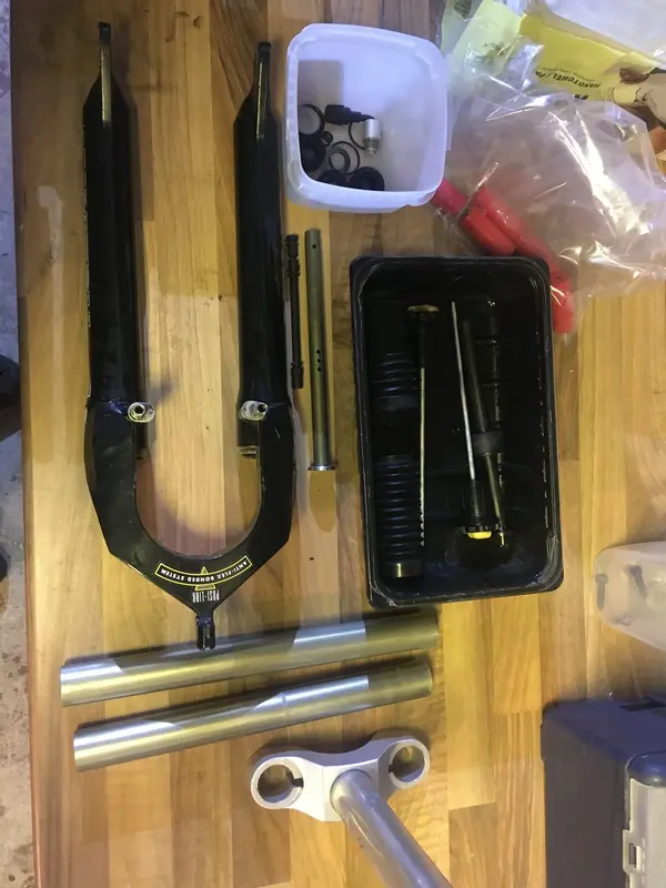

Looking for new elastomers to rebuild my (probably 1996) Manitou Mach 5 SX - especially 2nd and 3rd stage pieces.

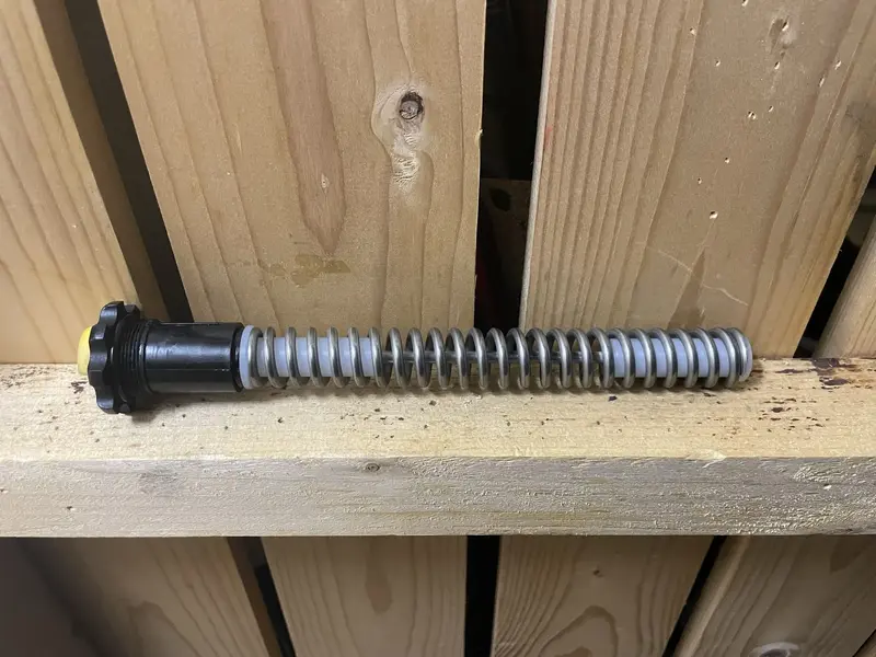

My suggestion, just put steel springs instead of elastomers:
Note: with these you must do some easy drilling, as the plastic centralizer needs a bit bigger hole for the rod of SX. Or you can remove the rods, drill a bit bigger hole into the compression preload adjuster for the screw in the plastic centralizer.

Exactly the fork I have here :). Could you provide a pic of the result / drilled stack? Fork travel stays the same or is a bit limited?
I use the setup like this. It gives approximately 50 mm of spring travel, and the bottom out elastomer maybe gives 10mm more for biggest hits. This setup will compress the spring maybe 3-4mm preload when screwed in, but if you leave the bottom centralizer away, then there's no preload (then total capacity of the spring is ~53mm). I woud guess the steel spring will take away few millimetres of the total travel (manufacturer claimed 63,5 mm?), but provides constant spring rate in both cold and warm temperature. In Finnish winter no elastomer fork works... There's a number of reasons why there's no elastomer suspension anymore :D
