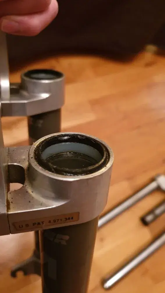

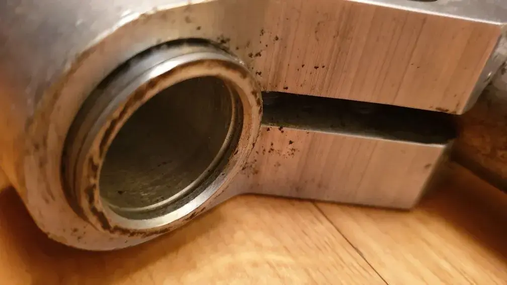

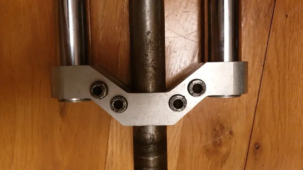

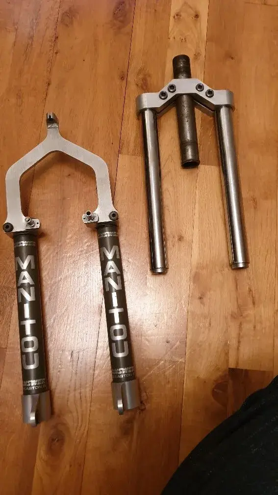

here you go dude... Hope this helps! Mine have been sat in the garage unused and needing Elastomers for the last half year :(

Thanks for the pic’s and measurements
Mine do look identical and yours has the white collar just under the wiper seals but none on the lower legs as shown in the manual

I've not had any 1s, but 2s and 3s. One set I had were missing the white 'collar', which I'm sure is the bushing. They have a sit in them so you can pop them out and replace. Perhaps they have hardened or expanded (or both) causing the stiction? Maybe some crude has got in behind them forcing them tight against the sanctions? Maybe one is displaced inside the legs?
