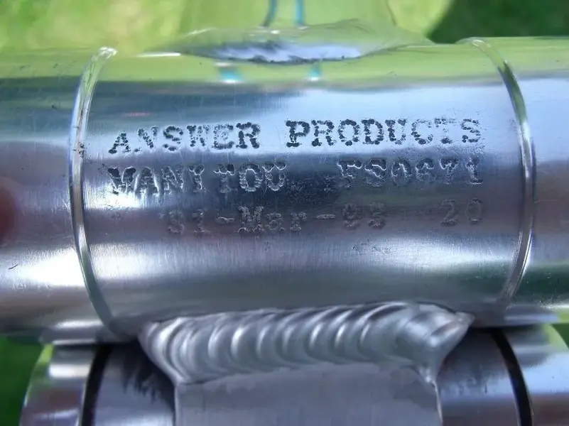

Mines FS0671, which I've alway took as being the serial number FS= full suspension and 0671 being the unique frame number
as for the number after the date in your case "17" I was under the impression it was the size as mines a 20 inch frame (see below)

I will double check mine tonight and pop it up, Im sure mine and Gio's are only a month apart on age date if memory serves.
