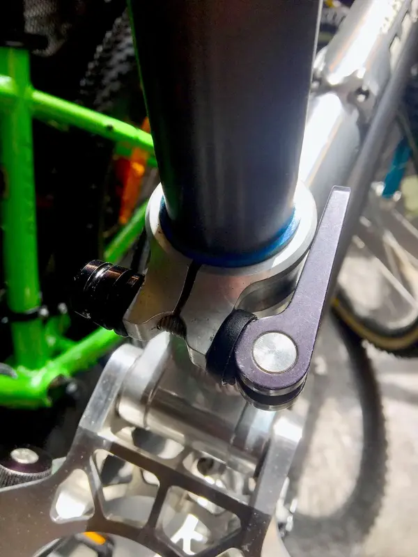

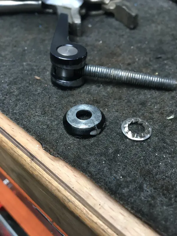

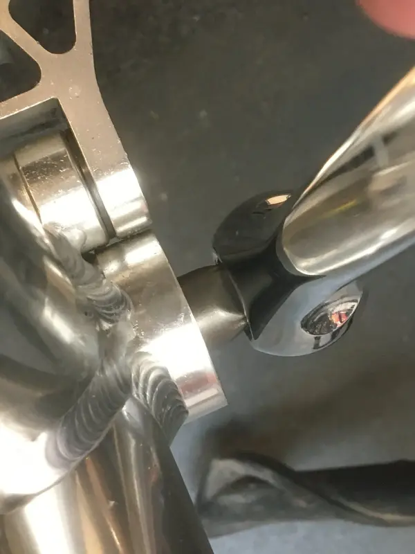

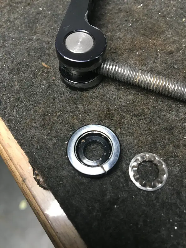

Ringle Seat clamp was broken, replace by a platic one.

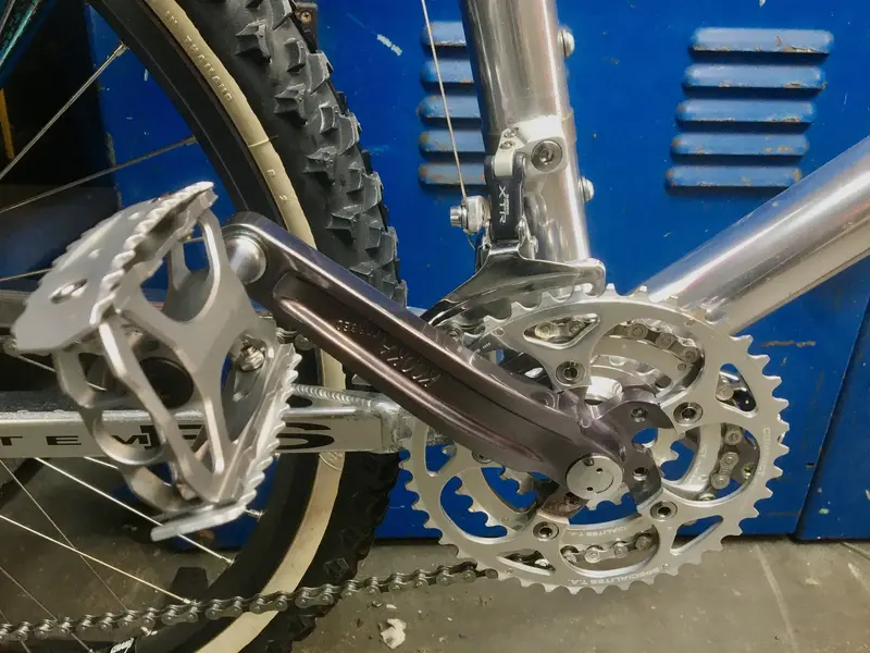

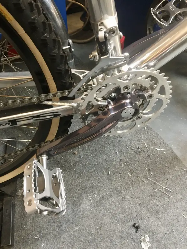

Next step. New crank. Topline & Ta cranks.

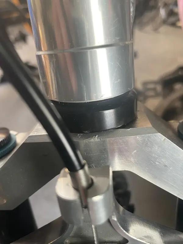

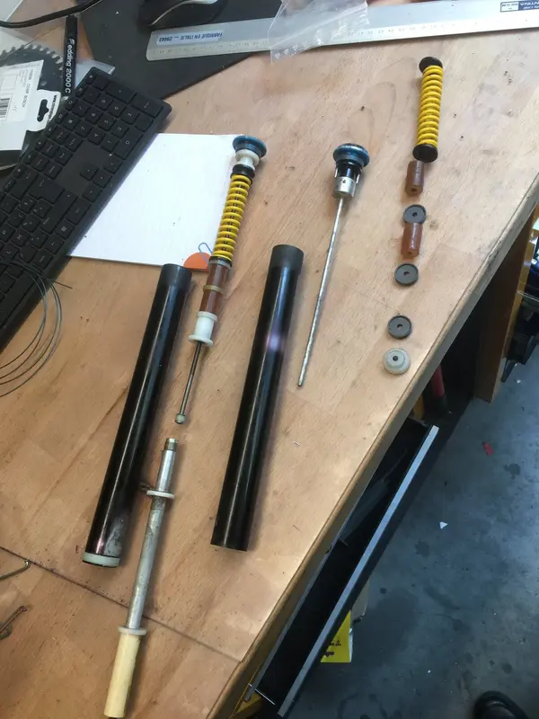

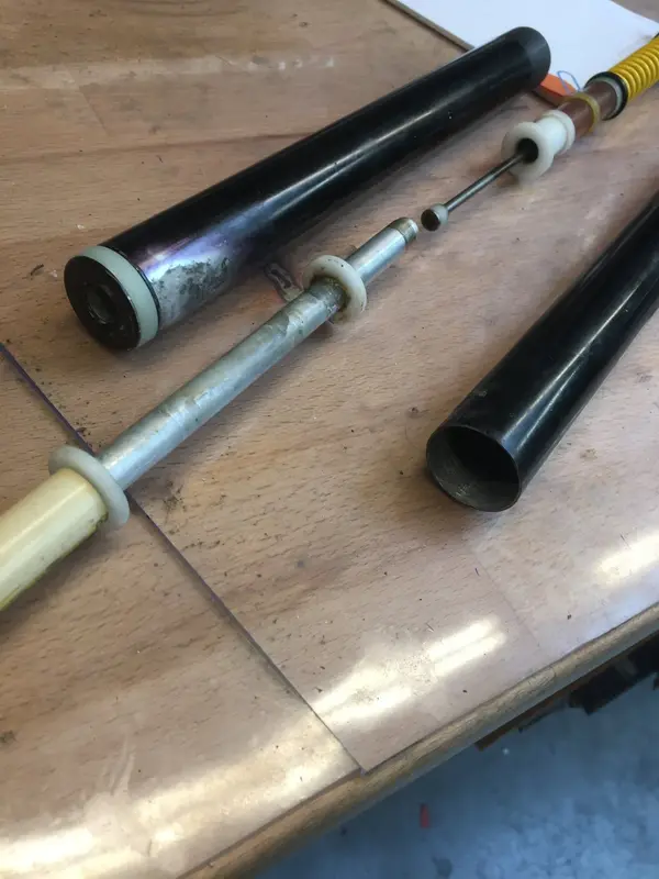

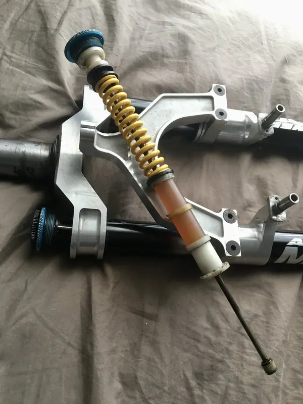

Hello,
Inside the Manitou 3 1 1/4 orignal on the frame. I found coil+elastomer combi, look in good shape, the rest is completely in bad condition, …
So many problems with Topline Micro D 131 mm bottom brackets still too short. Need too change, the crankset. 137 mm are too rare … and 142 mm are impossible to get a goog chain line.
Kooka forged are better choice, 115 mm bb is large enough. Light but coating looks fragile. Color is copper like. Nos.

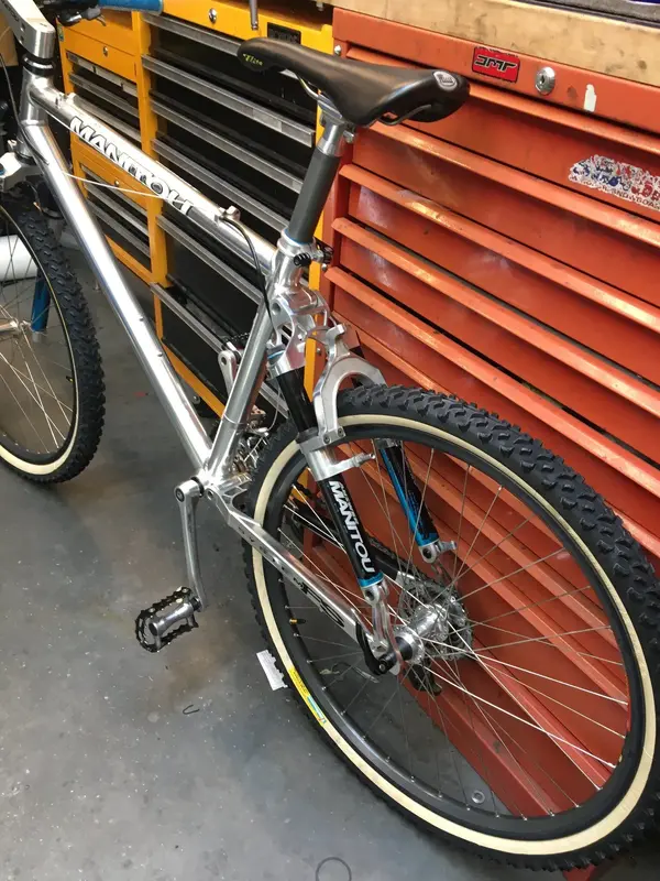

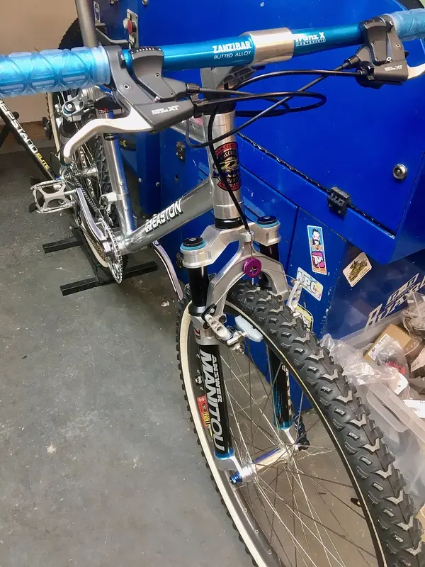

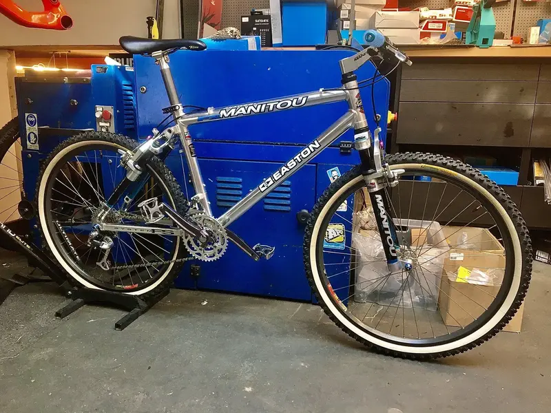

Rebuilding the original Manitou 3
Frame: Manitou Fs 1993 Size ; 18 inch
Fork: Manitou Three
Headset: Stronglight 1 1/8
Stem: Manitou
Stem Cap: Manitou
Handlebar: Zanzibar
Grips: Profile
Brakes: Wtb SpeedMaster
Brake Pads: Coolstop
Cantilever cable hangers: Cannibal
Brake Levers: Shimano XT m739
Shifters: Shimano XT m739
Front Derailleur: Shimano XTR m900
Rear Derailleur: Shimano XT m739
Cassette: Shimano XT
Chain: Shimano XT
Cranks: Kooka Forged
Chainrings: Ta specialites
Bottom Bracket: Shimano XT
Pedals: XLC
Hub Skewers: No Brands
Rims: Mavic D521 Ceramic
Hubs: No Brands
Tyres: Vittoria
Tubes: Michelin
Saddle: Selle Italia Flite
Seatpost: Ringle
Seatpost Binder: Ringle

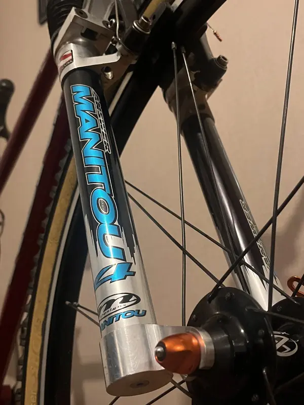

Great build I’d love one I wouldn’t ride it but what a piece of wall art . For anyone else who has issues with elastomers I used an old spoke and bent the end int a hook . I’ve just put some manitou 4 forks on my kona

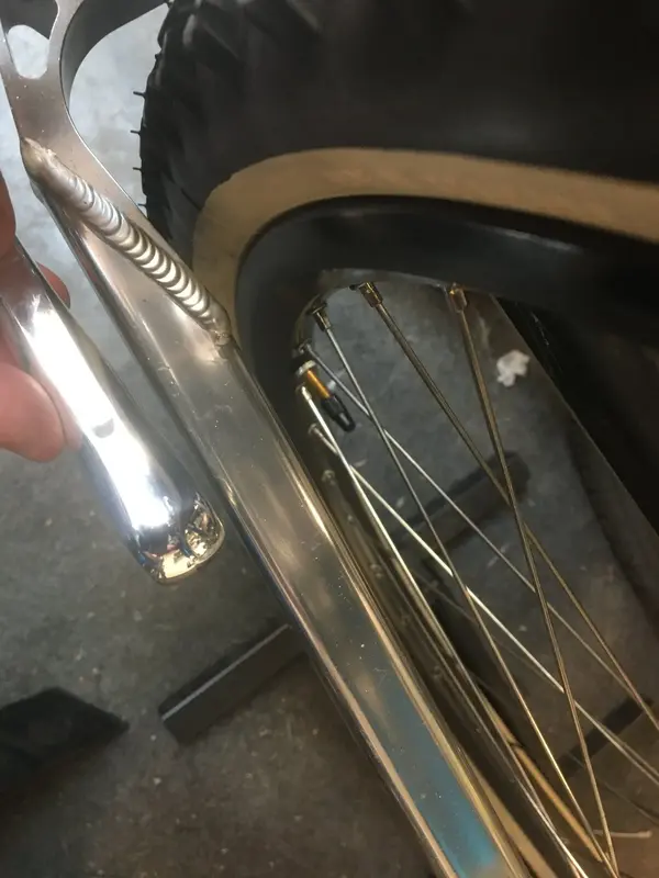

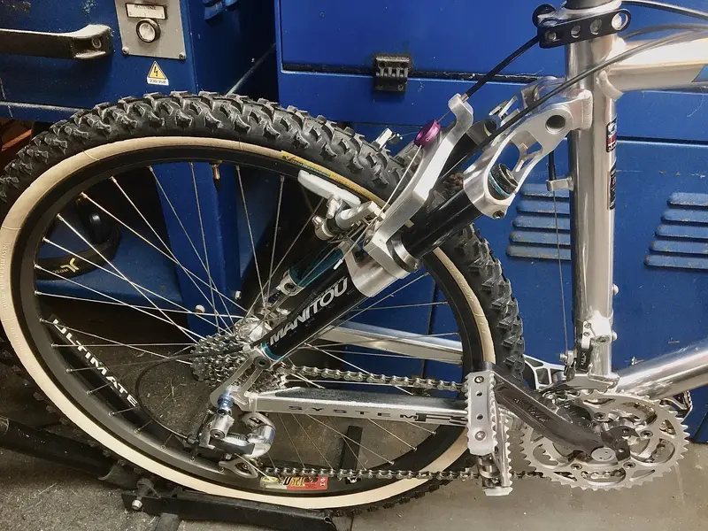

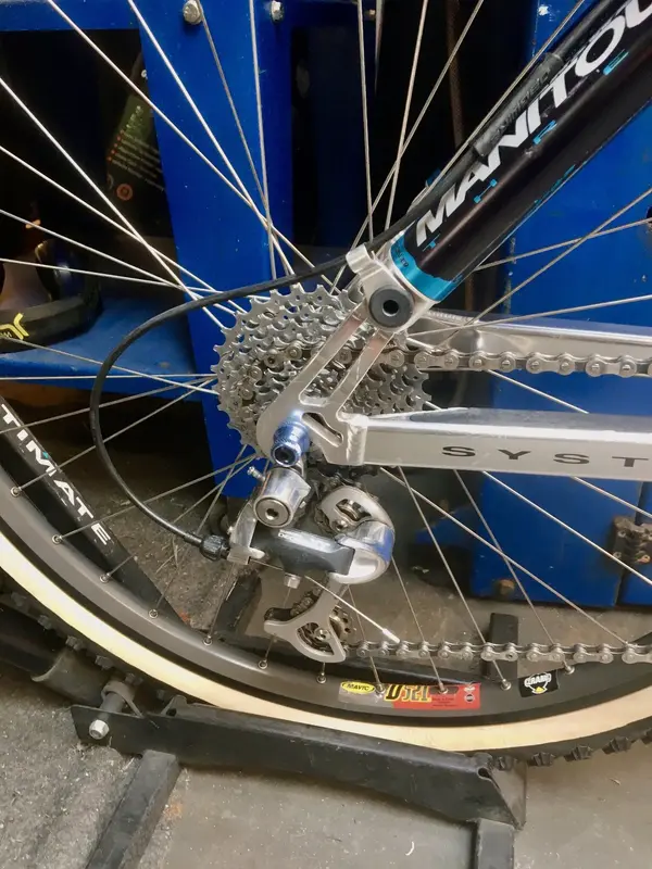

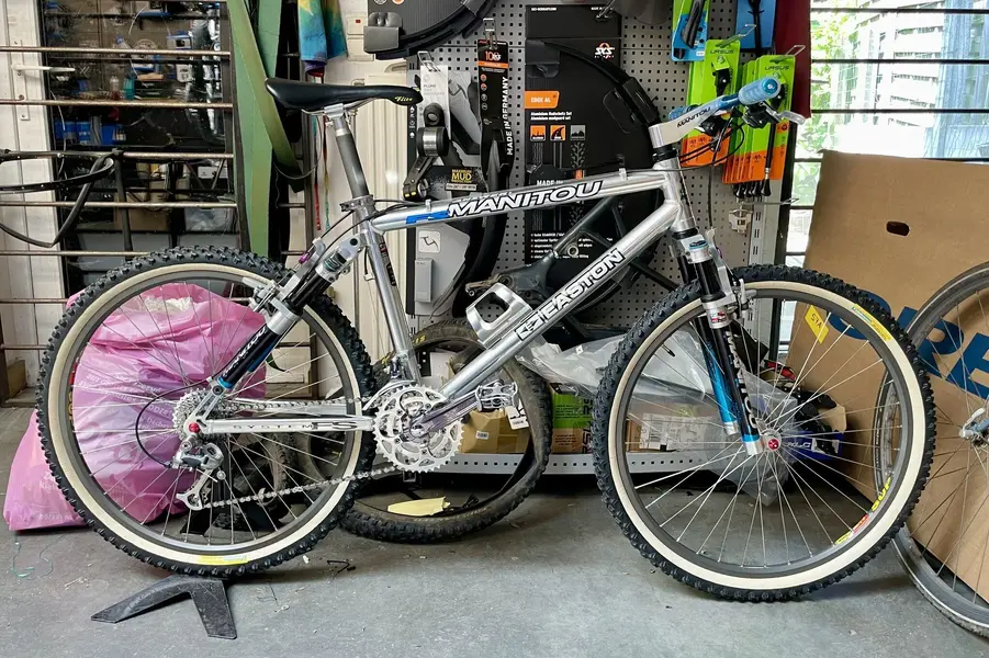

Hello,
Upgrade the wheels Mavic 217 (Nos) and Xtr m900 hubs. Unfortunately, the Manitou cracked, even without riding ! But I hope find someone to repaired it, …
