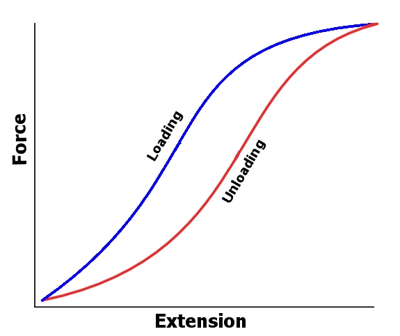

Engages physics teacher geek pedant mode.
A steel or titanium spring should obey Hooke's law whereby the amount of compression increases linearly as the amount of force increases. If you wanted to graph the behaviour of the spring, it would look like this:
small
The amount of energy stored in the spring is equal to the area under the graph for a given amount of compression.
An elastomer is made of a polymer and so does not obey Hooke's law. Its graph looks like this:
The key point is that the elastomer behaves differently under compression than it does under extension. The area under the blue line on the graph is bigger than the area under the red area. This means that not all the energy stored in the elastomer as it compresses is returned as useful work when the spring extends. The difference can be accounted for by internal heating of the elastomer.
Broadly speaking, this is what a damper does too - it converts kinetic energy into heat but it does it in a somewhat more controlled and refined way than the elastomer does.
