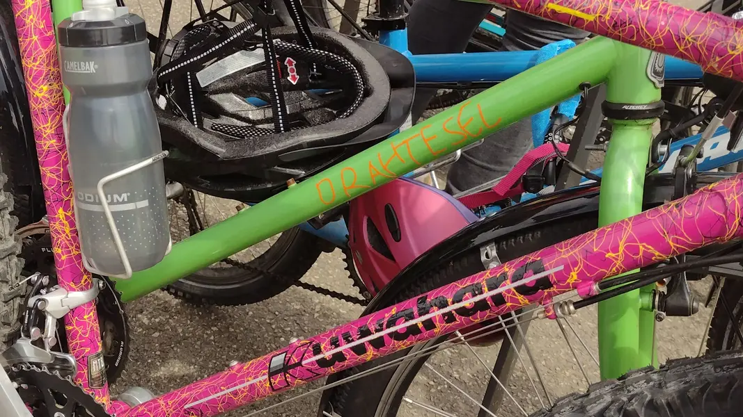

I also had a vinyl cutter and monochrome lettering works very well as long as the lines are not too thin (see the green bike).
I drew the designs myself using Sketchbook and then prepared them for cutting using the plotter software. This has always worked quite well.

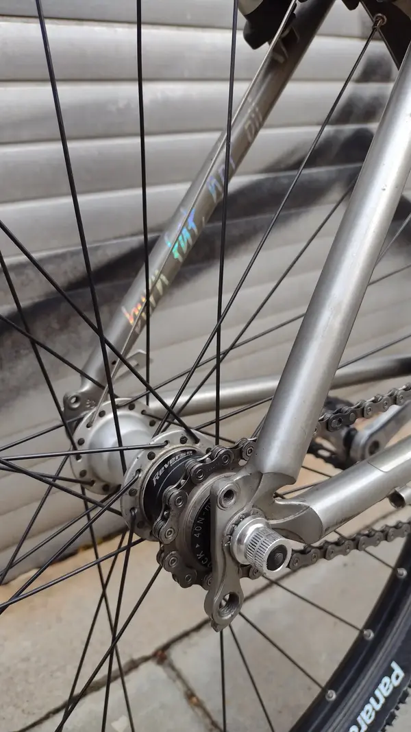

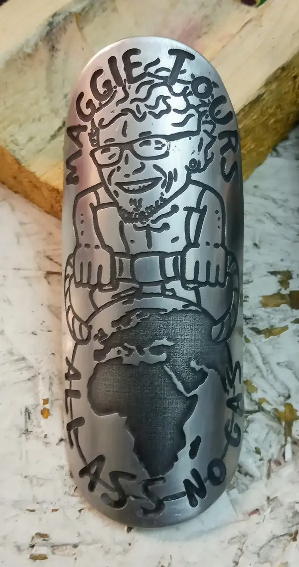

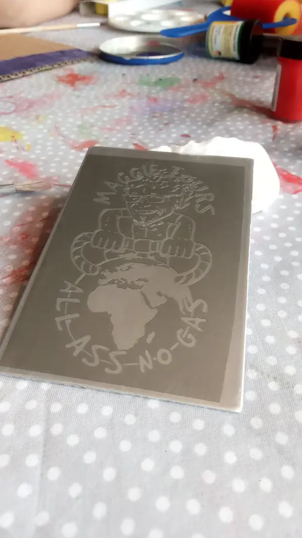

I've also made stencils for painting or etching (headbadges, quite small) but also decals that have held up quite well so far, but that's more down to the film.
