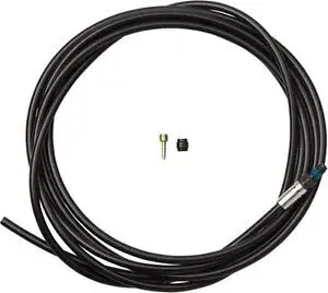

Looking around I see this...
The silver part looks like a hose stop and I think all Maguras use the same olive as the one in the picture is the same as my HS33 olives
Theres a tool to insert the barb. I shortened a hose on a pair of julies and couldn't get the barb into the hose despite lots of swearing. Damn site harder than putting a barb into shimano hose in my opinion.

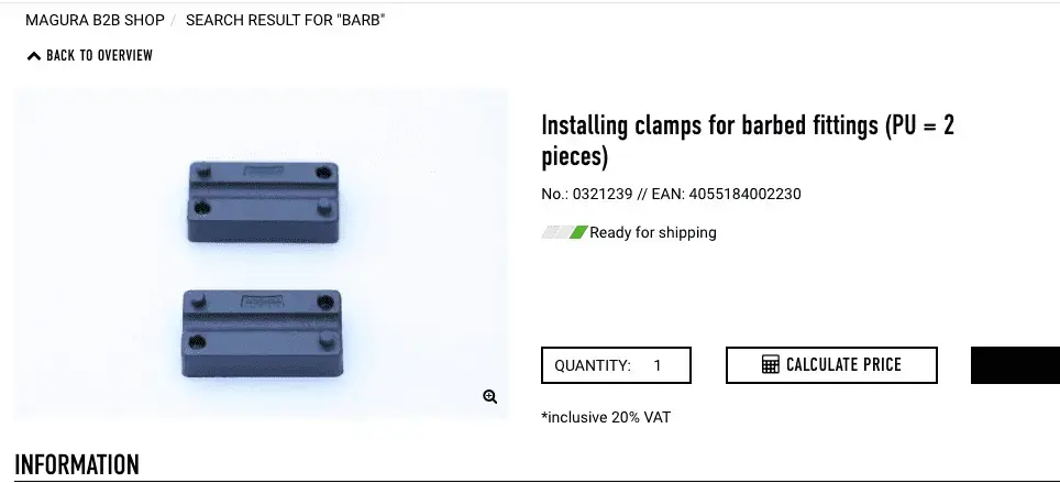

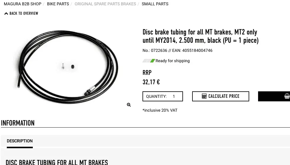

I've got a account with Magura
There are x2 different sleeve nuts but the olive and the barbs are the same for both.
You can't use the same fitting at both ends though as nothing to compress the olive at the calliper end and its a different pitch thread.
There are x2 tools but the clamp and a small hammer work fine!
