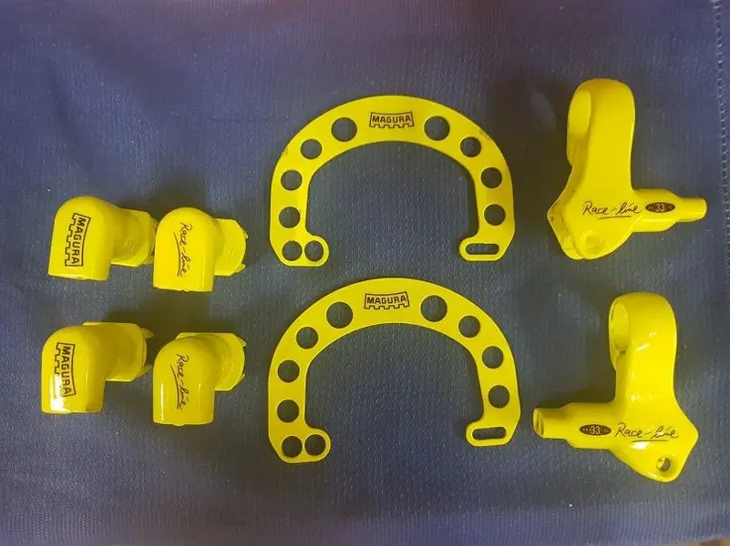

Cheers Mick,
ill get some mineral oil then, will need some anyway for my modern bike for when thats due.
Cheers
Barry

Looking forward to hearing/seeing the results
After applying the water slides are you clear coating them or leaving as is ?
Yes another clear coat and then i can bleed them up and put them on.

Update
Decals applied, and 2 x clear coat applied.
Next pic will be of them on the bike!
