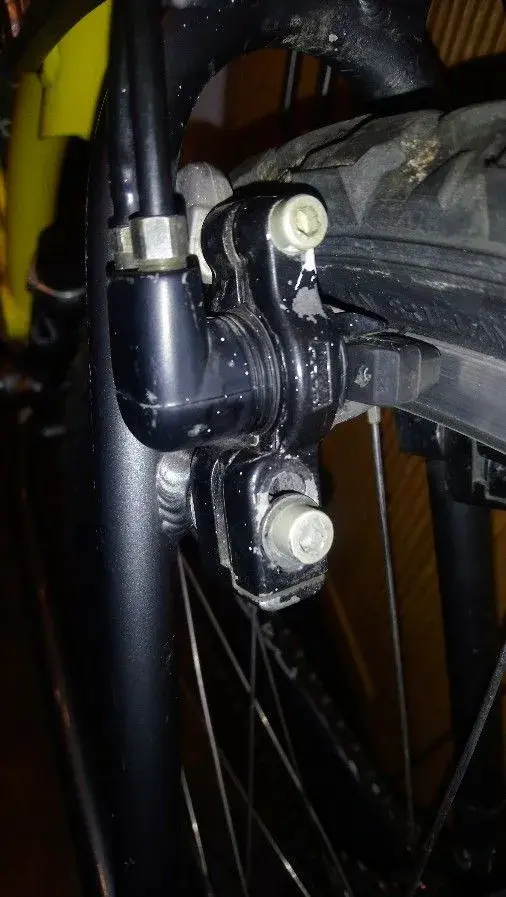

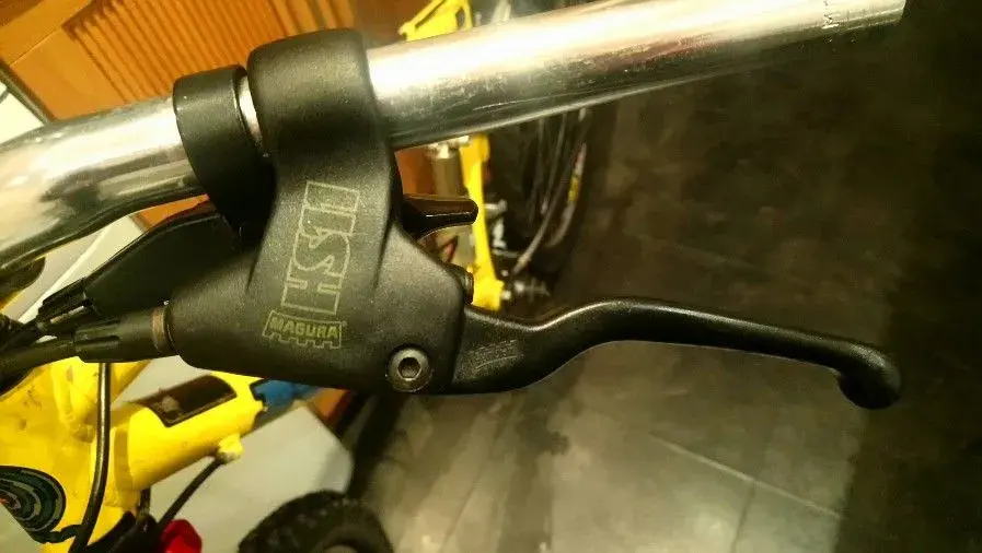

Updating this thread as I've now got a set of HS11's, which appear to work flawlessly, and on first impressions seem to have similar power to both the HS22's, and HS33 Race lines which I've got on other bikes. In my experience brake boosters help a lot with these brakes, so I'll have to find/dig some out of the spares box.
The finish is low rent black plastic for the levers, but the Calipers seem the same as other models.
These were OEM equipment on some Kona bikes c.1996 (as per the Kona catalogue linked to by the original post).

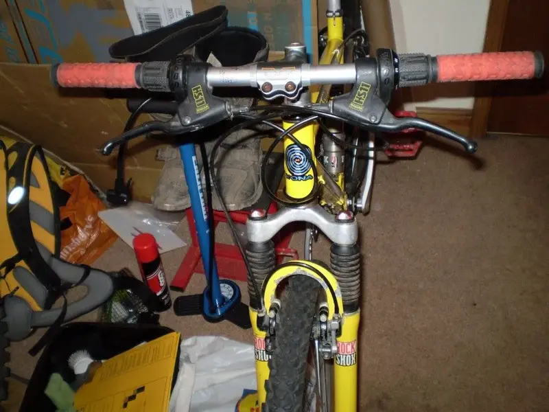

Really like Maguras and the HS11 are as good as any ive used. One of the best things is once set up they are pretty much maintainence free.
