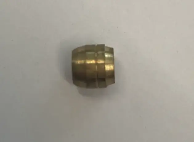

- Brake Olives - are these the same for the braided and Nylon Hose ?

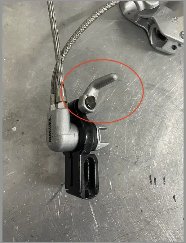

- The part that goes behind the brake with a spline .. see picture .. just need one as it was missing from my kit

I have a Magura branded braided hose kit on one of my sets, I'm 99% certain it's a rebadged Goodridge kit, it doesn't use olives and the fittings are reusable, post a pic of the lever/hose connection and I'll tell you if it's the same. :)

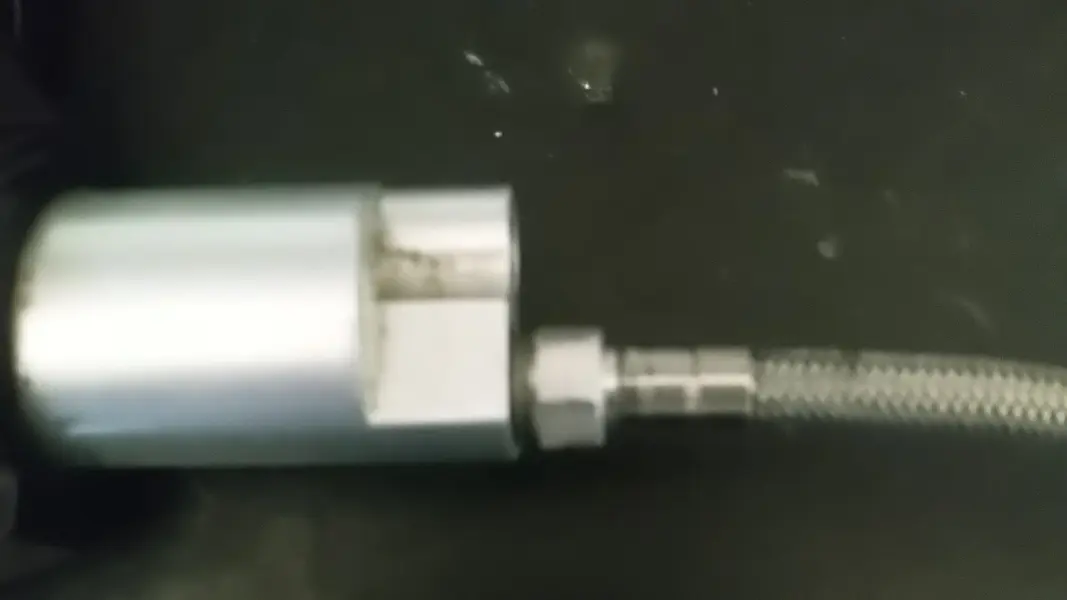

Picture attached .
Thanks

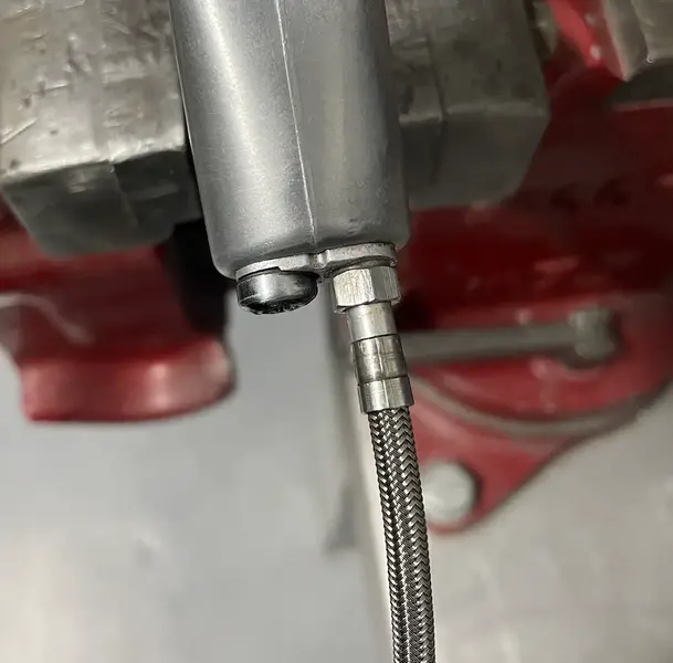

That looks very similar to mine. This is in an Altek lever but it's the same thread. _20241026_213057.webp Now I see it though obviously that's the crimped end that you can't shorten! 😬😁 The other end at the caliper hopefully looks like this, the top one. _20241026_213122.webp
You unscrew it from the caliper, unscrew the shroud nut, then the fitting uncrews from the hose, cut the hose then screw it all back together. Hopefully that makes sense. 👍 😁
