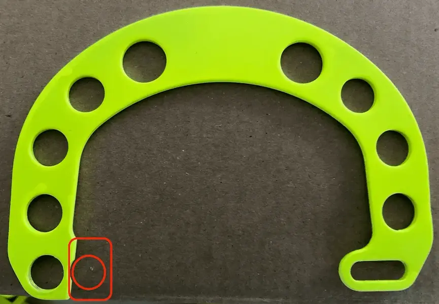

Has a chunk been cut off this brake booster? I bought a set of Magura HS33 brakes with only one booster. Ignore the fact I screwed up the repainting, has the mounting hole been cut off? Looking at photos online, and offering it up to a bike I think it has.

Yep been cut off, the way I see it it’s to do with tire width and rim width getting wider, it’s essentially made that first hole Redundant and also in the way so they get cut off.
As all the above have said, yes it's been cut off, a very common thing to do, I did/do it too as sometimes even 2.1 tyres can be a pain to get the wheel out/ Q/R side brake off. It'll still fit just fine and work as normal, someone has saved you the trouble of cutting the extra hole off :wink:
Great feedback, thanks all. I've dissembled everything, so those manuals will be used for more than just this query now too.
