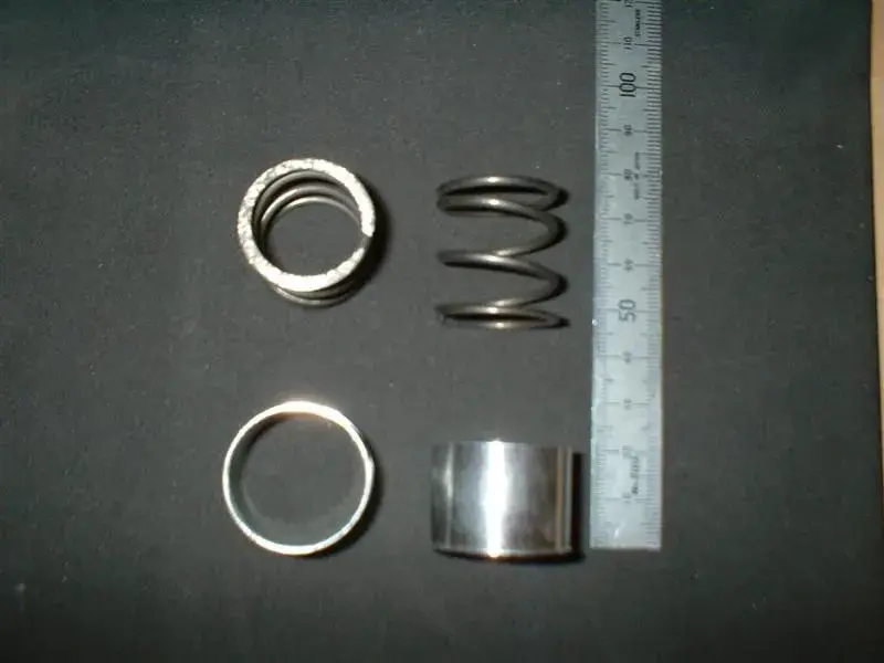

right , heres what you get in a RS 93 - 97 mag 10/21 long travel kit
and from what i remember , the silver bushings are about 12mm shorter than the standard ones

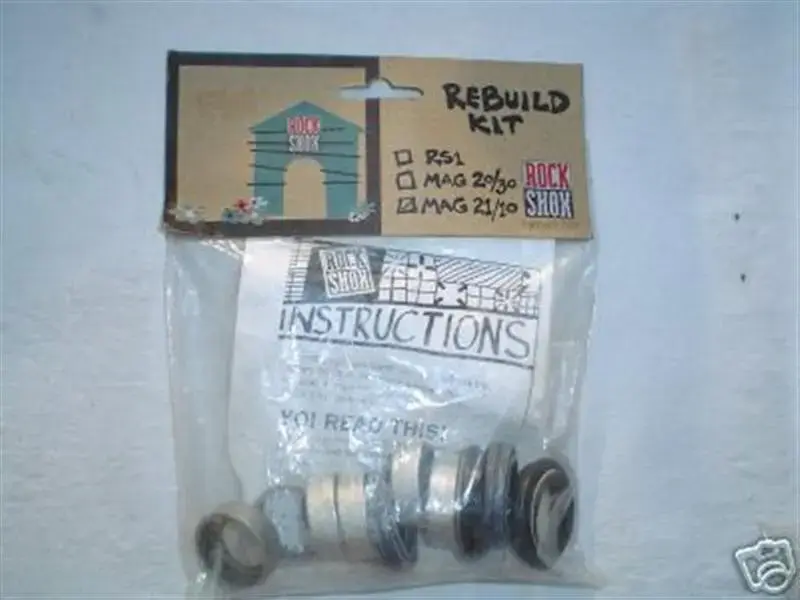

and heres the rebuild kit .............
which includes as a bonus , bushes for a mag 20
dee eight , who`s site it is , says you can actually cut them down to prctically nothing , depending on how brave you are :D
