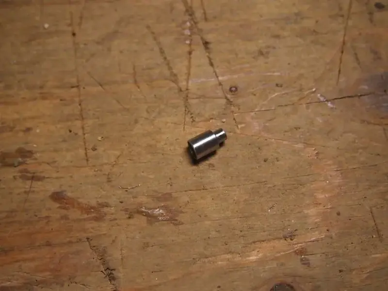

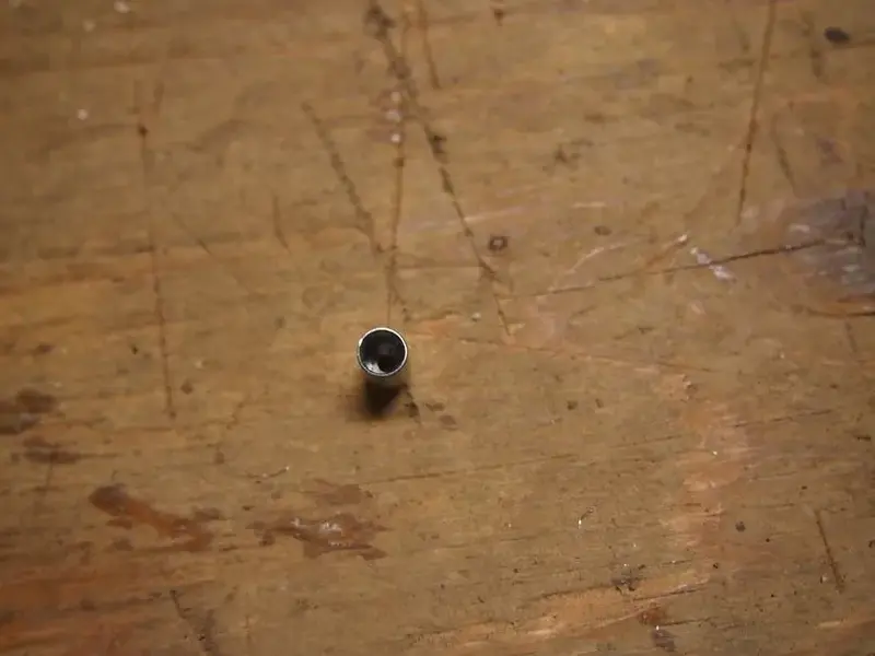

Just yesterday I got a broken dual lever and a good single tandem lever. They are not the same - not even the single - as all the other "normal" Mafac levers I have; the curve is different, and the tandem single has a larger adjuster hole and takes an adjuster with a larger small section (this is a Good Thing as all the normal Mafac ones break at the skinny part); and the access from behind the lever is larger (also a Good Thing when you have to get more than one cable in there).
The part that was broken was the lever itself; I have transplanted the dual-nipple bit into the single lever and put the pair in the dual-housing. The dual housing is missing one of the chrome-plated ferrules; I'm turning a replacement out of stainless; so it will be what you need - one side, anyway.
I haven't posted enough to be able to pm you; can't be bothered posting drivel just to reach whatever target it is, so you'll have to pm me an email address.
edit: ferrule done - pics...
