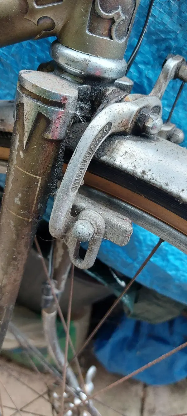

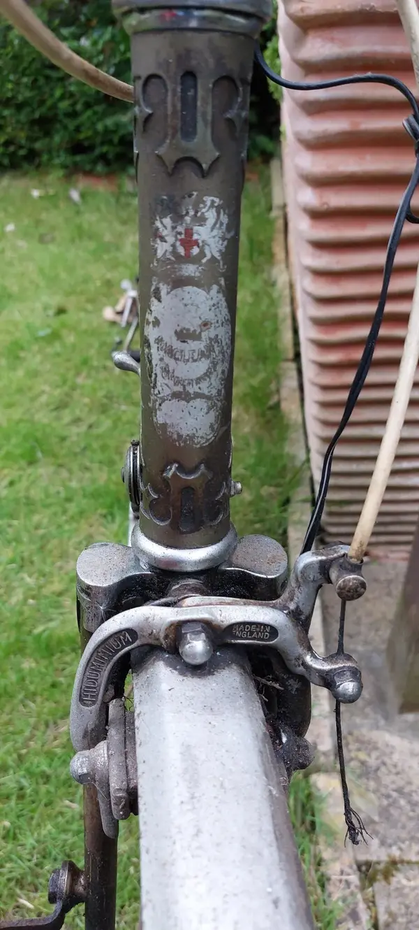

No time yet to start on this plus need to make space, so Pug and Raleigh that came with it need to go quickly (if anyone is interested please let me know). Some pics before any cleaning attempted - BTW, what do you recommend to use as not to strip of any paint yet clean it up nicely?

Lovely that. Good to see some nice greasy bits you just now are going to clean up well. Some of the greasy/less delicate parts I’d go wd40 and a toothbrush or something similar. Those parts where it still has the decals I’m really not sure, looks quite delicate and would be a shame to lose any more.

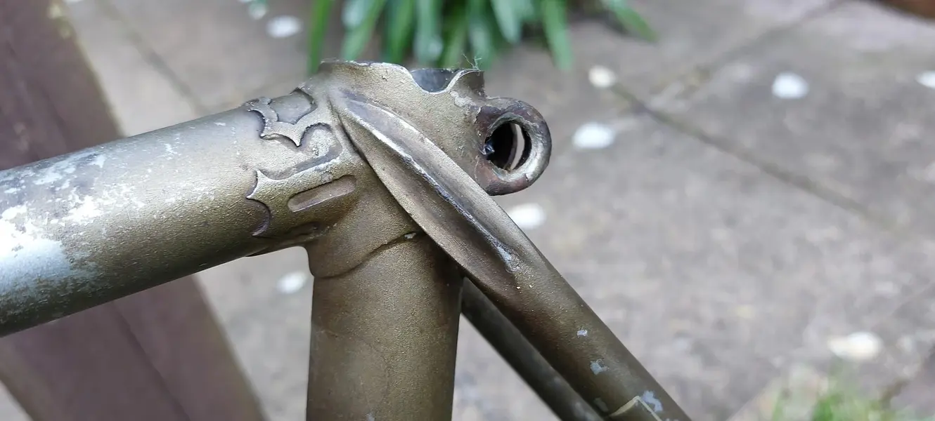

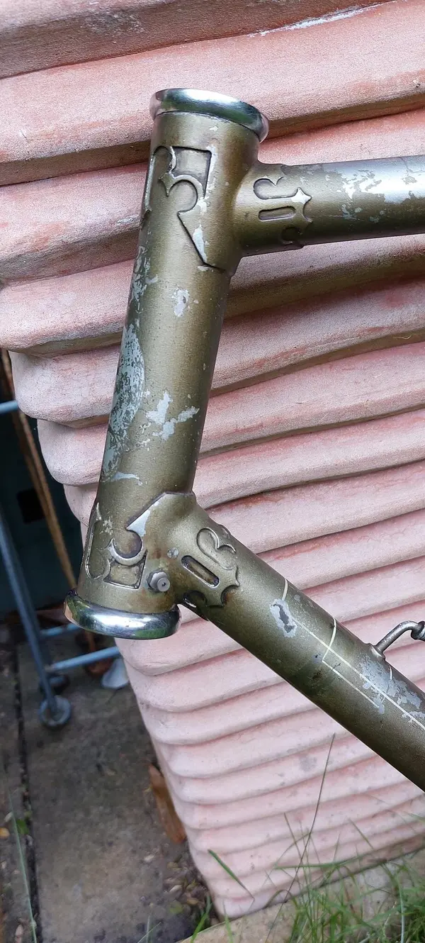

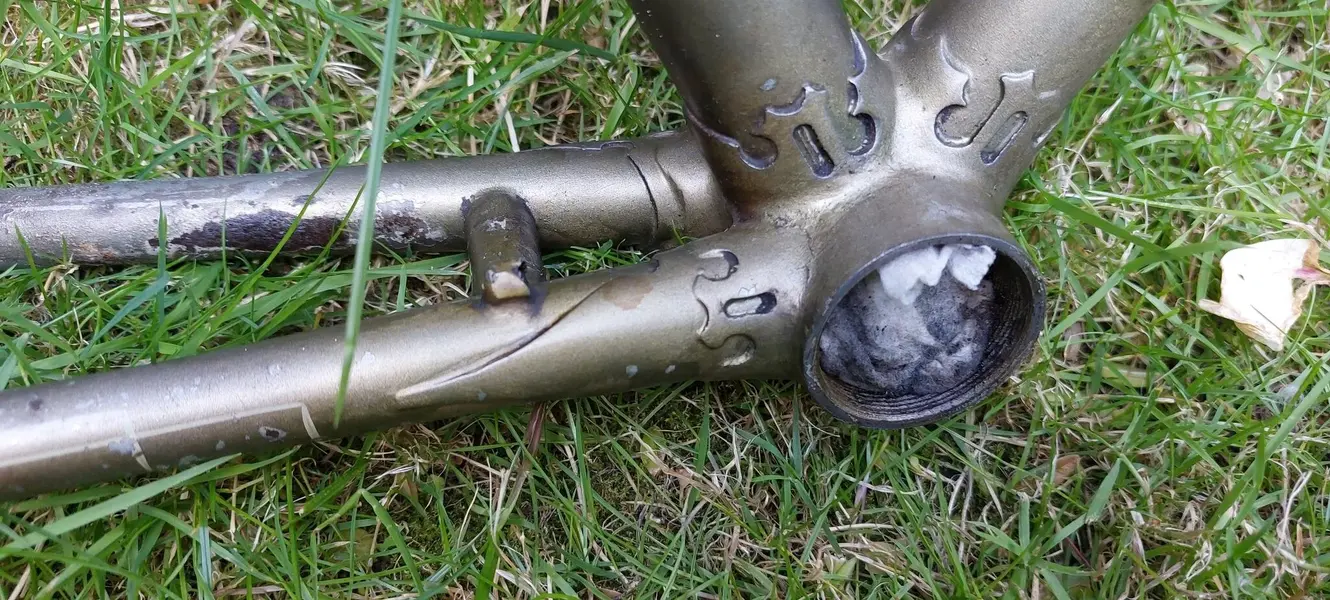

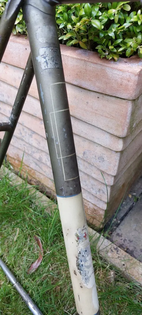

Right. Stripped to bear bones, washed, dried, 0000 wire wool and WD40 treatment for bear metal and chrome, rest will get polish tomorrow, after cleaning all the nooks and crannies around lugs. Patience needed. Aside those superb lugs (check the bottom bracket shell lugs), really different o any other frame builder, the frame had also had equally nicely done box lining over what appears to be golden coloured paint, pity top tube has lost most of paint, although you can see remains of box lining looked like.

Hiduminium brakes and GB calipers

Amazing patina - maclean made some nice frames and not too many survived😪

the lug within a lug bb shell at the Chainstay
And the
medieval-come-arts-and-crafts
lugwork. Incredibly unusual.
I think it's a careworn beauty
