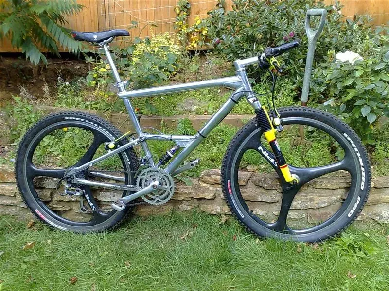

mt gt rts was in a very poor state when I bought it and really needed a decent polish.
I used a brillo pad to start with (the ones with the pink soap in) and a bucket of water.
Next I used some wet and dry sand paper (used wet).
Lastly I finished it off with good old T-cut and a yellow duster.
I got such a good finish that in the end I did the swing arm and exhaust silencer on my crosser :oops:

wow i love the look i think the wife has some polishing to do it looks great. could i put some laquer over the top to keep it in that condition or is it best just polished
Graeme
autosol and duraglit work well too say the mrs :lol:
mine is bare alloy and i give it a quick t-cut every now and again.
how about this one? A buff Cannondale...I likeee! :D
