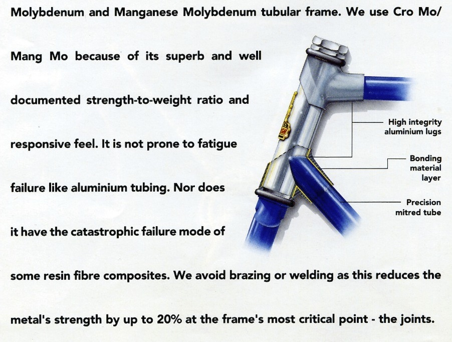

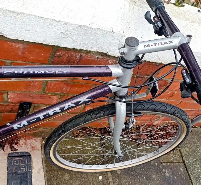

Looking at the image they do look 'butted/lugged' which would indicate bonding according to that diagram image:

ok, the frame you are looking at is a 1995 Raleigh M-Trax 2000. These are built with a Reynolds K2 Chromoly steel frameset.
The tubes are brazed with brass into the lugs. These are the same framesets used in the earlier Raleigh models of Summit, Peak, Ravine etc.
Also available in that range were the M-trax Ti bikes, these were built with the Titanium top tube and down tube bonded into steel lugs
and alloy headtube, these Ti bikes are the same frames as the 1994 Dyna-Tech range.
These frames are really good and very strong. Best to build it up with Mavic rims and stx-rc or above groupset.

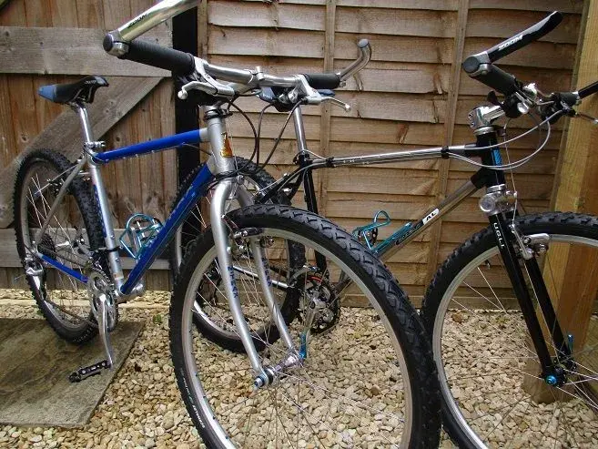

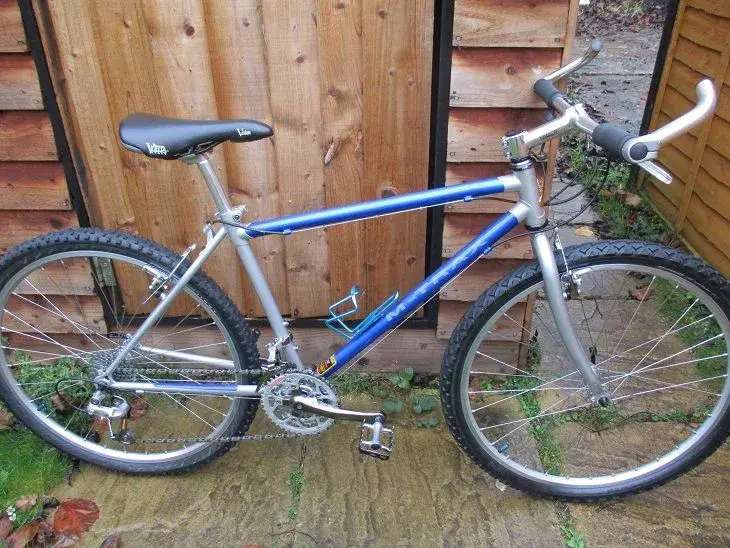

heres some of my Raleighs, the two bikes together the blue one is a K2 brazed and the black one is a Titanium bonded (all still in one piece)
