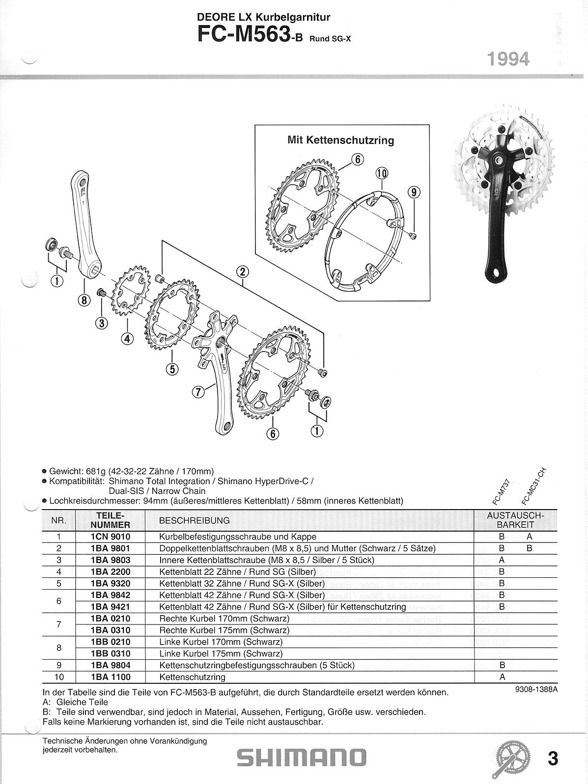

Can somebody tell me whether the Black LX cranks from the 1994 8 speed group are ATB or compact size please?
http://www.fa-technik.adfc.de/Herstelle ... en.html#94

you mean this
or one of the other many M56x's
but yes Compact.

I'd measure them to be sure, my black M560s are 110/74s. So it looks like the M563s was when they went 94/58. Mine came 46-36-26, but maybe that was '93 (now I'm writing this, this group was 7 speed so I might be barking up the wrong tree) I'm sure someone will know. Here's a couple of pics of my M560s 64.7mm C-C = 110mm BCD. I think...
the black cranks of 1993, M560, where non compact, but from 1994 onwards were, and i believe they are M563.

The 1994 Eldridge Grade was 7 speed not 8 speed and used the M563-B cranks in compact drive. Believe it was 1995 groupset year that they switched to 8 speed.
