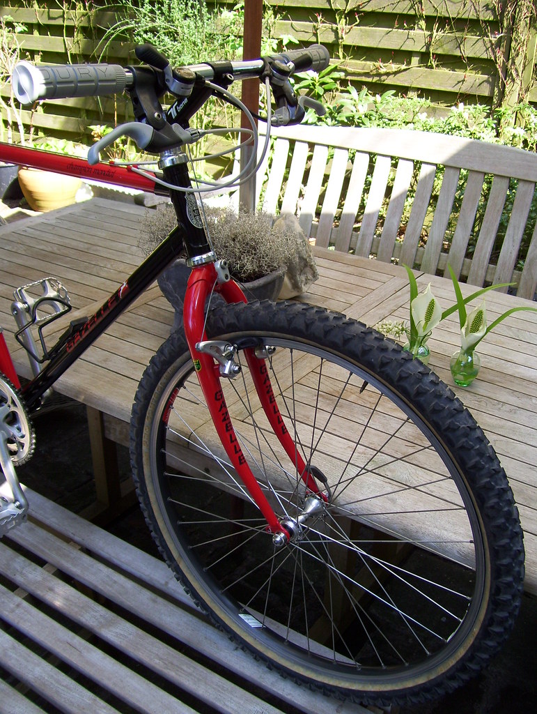

My Diamondback does, but the only picture I have at the moment is this:
