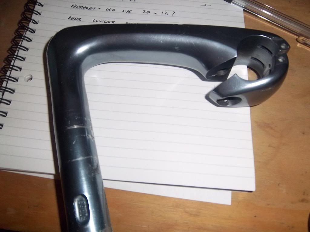

I was messing about in the garage last night - pondering a 6sp build with aero bars to mess about on. I checked a few bits and bobs and was looking at a stem which might work with the bars i have. As i pondered i saw a small crack in the stem, bearing in mind i still need glasses, this was a lucky escape.
Have a look -

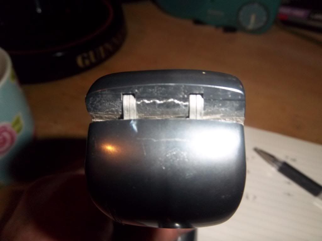

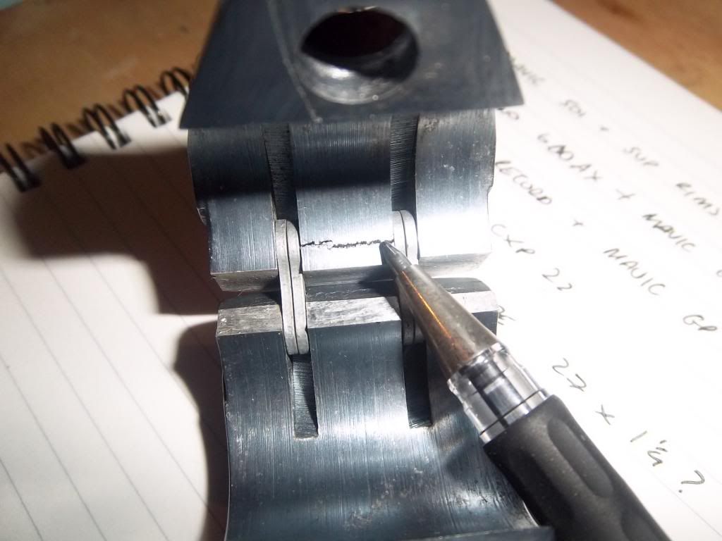

There are 2 small cranks in the section between the hinges. I dread to think what would have happened if it had broken with me on the bike.
The stem is a 3TTT one but i am not sure of the model.
Richard
Yep, those hinged stems are known for cracking at the hinges. I think cinelli also made one like that.
Just to clarify for anyone who has one - there are two cracks - one in the hinged section and one in the stem section.
If the seller wants to give me a refund i am sure we could work something out (pity i have no idea who i bought it from!).
Richard
matthew71":1exoqo3s said:
I have one of them stems on my gazelle. Might give it s check at the weekend
I have the same stem too mate, went and checked ASAP :( Mine is fine though :D :D :D
Nob":1exoqo3s said:
weak link on this stem & also over torqueing doesn't help either
Dare I speak Nob? Yes over tightening of parts is a major problem and some think ''I'll tighten it up that bit more for good luck'' :?
