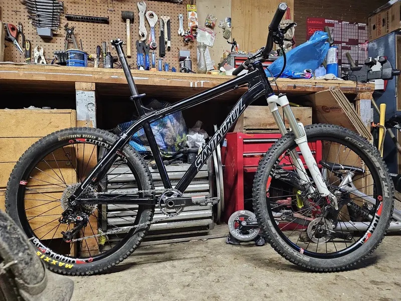

I would be interested in seeing what they look like. I have industry nine hydra straight pull hubs and have the qr axle caps on it now. I was trying to find a nice 15mm to kinda make it feel like a enduro hardtail but I can compromise with a qr. It's a xl santa cruz chameleon 4.

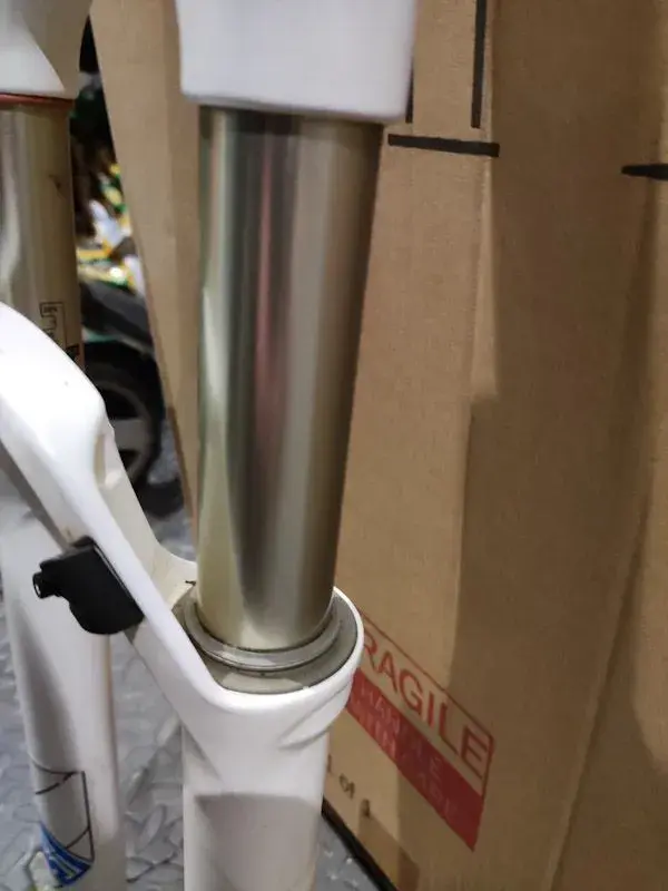

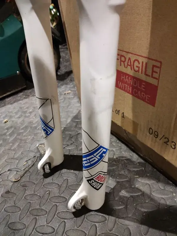

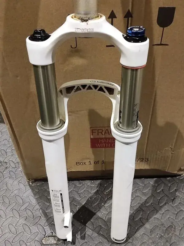

Here are some pics. I've not given them a clean but they are very tidy despite this. Not much in the way of marks to the lowers, uppers are unmarked. Fully working, I have the remote lever too, it just wasn't to hand when I grabbed the pics.

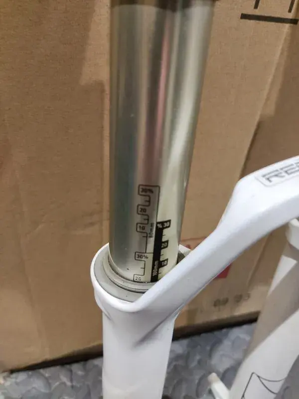

These are in great shape. Are they 100mm or 120mm? I think the bike could handle a short travel fork. It's mostly going to be used for xc, but I'd like to have it capable to ride a little more rough. The fork in the picture is about a inch too short to use on this frame. I am hoping to eventually run a 15mm fork to make the front end stiffer. The rest of the spec would be perfect for a all day bike. So I'd need it to be robust.
The fork is set at 100mm but as it's dual air, it can be adjusted internally by removing travel spacers from the air shaft to get 120mm, which you can't do with solo air versions, they need the air side damper shaft replacing. The forks are marked with sag indicators for 80, 100 and 120 so you could drop the travel by adding more spacers too.
It's a simple job I've done many times the official way. Release all air from positive and negative air valves. Remove uppers from lowers, remove air side damper shaft, remove travel spacers. Rebuild, adding some 5ccs of fluid in each lower leg via bolt holes before bolting it all back up. I've read of an alternate method, though not tried it. Release air from positive and negative air valves. Remove positive air cap from crown. Compress forks fully. Theory is you can pop the damper shaft out the top, remove travel spacers then reverse like I said though, never tried.
