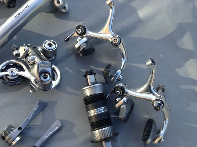

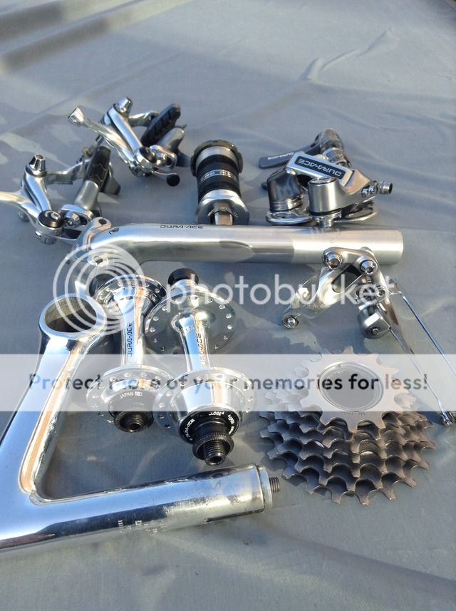

I'm back... so have spent last few months starting to pull together all the bits. Apologies for gratuitous photos of Dura Ace 7400 (and 7401) bits for 7 speed SIS group.

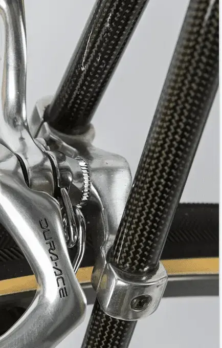

Thats looking good Robster, so glad you went with the Dura Ace, my recent TVT build rides brilliantly and the only real difference here is the rear end, my TVT has a one piece carbon wishbone with a small metal insert for the rear brake. I'd be interested to know if the forks are one piece carbon with a titanium sleeve over the steerer like mine?
I've never seen a wishbone rear end on a TVT any chance you could post a couple of photos of yours Doubledee please.
Also can you explain a bit more about The Forks on yours i.e. "one piece carbon with a titanium sleeve over the steerer" again maybe some photos.
Thanks
The TVT wishbone well not exactly see my current build thread it's on the first page but what I meant to say was that the rear stays are all carbon including the rear brake bridge as opposed to the aluminium ones. The forks on the TVTs are one piece carbon but so a threaded steerer could be used they put a metal sleeve over it and pinned and bonded in place, when I took it to my friend Will at Wills Wheels he told me the sleeve was titanium

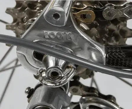

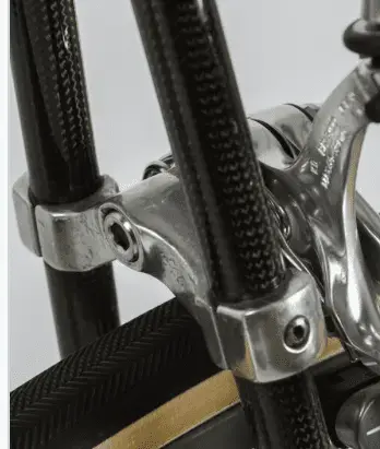

Ok I understand what you say re the Seat stays IMHO the steerer tube is steel NOT Titanium. (on all the ones I've ever seen) This is couple of photos of the rear Brake bridge on my Look KG86.
I think what Robster914 has is a 1st edition of the TVT (straight seat stays) as used by Greg Lemond & Bernard Hinault and some of the La Vie Claire team in 1986 except that there's were sprayed a Ice Blue colour. My look/TVT 86 is (I THINK) the 2nd type still with the straight seat stays & slightly different seat Lug. All the ones that came after 1988/9 had the the seat stays curve inward above the brake bridge, which by that time was a one piece moulded Carbon affair.
Had that been my frame I would have had it resprayed in the La Vie Claire 1986 colours & done a replica of that bike (I've never seen one available for sale) easy for me to say I know as I have 6 other versions of the Look/TVT bikes. BUT a 1986 one would be a very very rare bike indeed & this is the first one I've seen that matches frame exactly. There was another much later version TVT without the 2 alloy head lugs it looks like one piece of moulded carbon for the head tube.

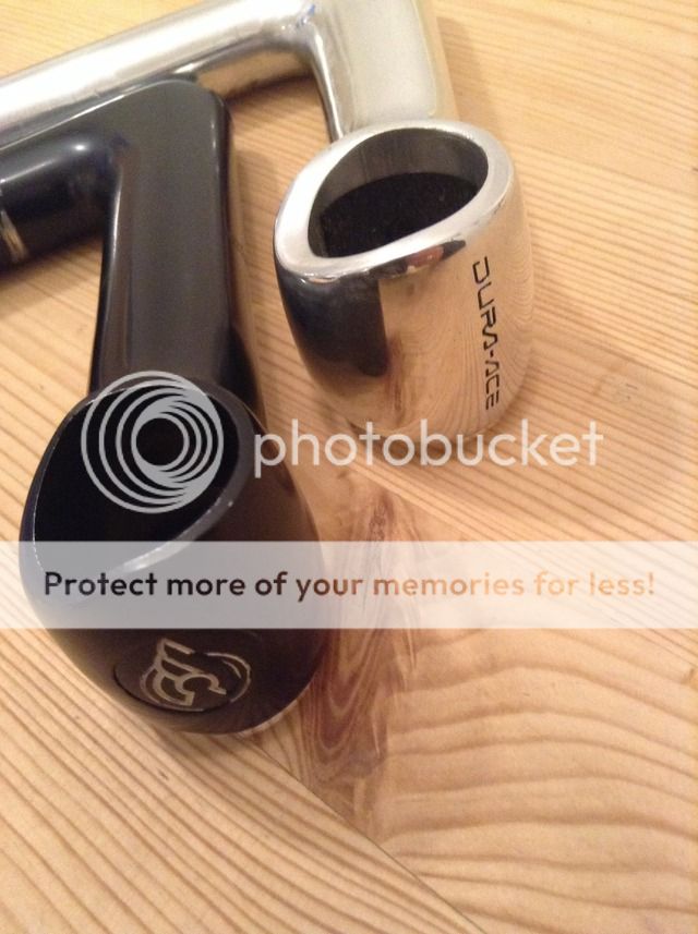

I know there are worse quandaries, but I have a Dura Ace stem, and a Cinelli 1R. I like the idea of having a complete Dura Ace 'Gruppo' on it, but it should really have a Cinelli 1R (or 1a) to be period correct as per the team bikes.
Either way, the Cinelli stem I have picked up is black, so will need some work. It is sitting in the garage covered in Nitromors at the moment, before and after shots will follow I am sure!
I have heard they can be a bit problematic with squeaking handlebars or not being good at securing the bars. If it was good enough for Lemond, Hinault et al I am sure it may fine..
Within the last week I have stripped a black 1R - turns out you don't need paint stripper, I sanded it very lightly and then used BBQ cleaner. Came off in minutes. Might just save yourself a lot of effort rather than the nitromors route.

Hi Finney, thanks for the top tip.
I left the stem covered in Nitromors overnight and it hadn't even touched the finish!
I am sure they have changed the 'recipe' - it used to be able to take paint off anything- much like the Alien goo that could melt through floors on the Nostromo!
Not sure where I can find bbq cleaner in January but the hunt is on.. :D
Wilko's oven cleaner; £3.00. Comes in a white box. I use it for everything I need to de-anodise. You're correct about Nitromors - stinks like it always has but doesn't cut the mustard like it used to.
