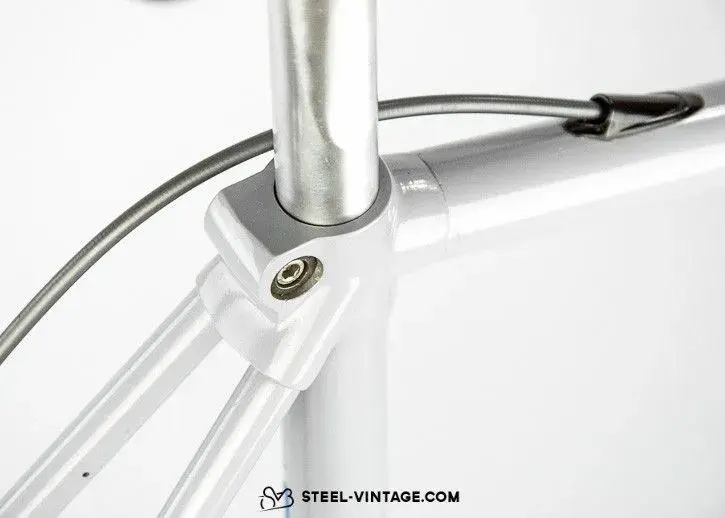

Look KG241 seat post clamp.
krankers
Does anyone own one of these frames or similar, and can shed any light on the seat post clamp situation. My frame came with a wedge, similar to a quill stem wedge, and a bolt. JE James list the same item but it just doesn't look right to me, looks like there should be another wedge for it to work. I haven't got a seatpost so can't really give it a try. Just wondering if any other Look owners might know the answer.
there are meant to be 2 wedges I am sure , one side is threaded and the bolt slides though the other
Thanks for that, pretty much confirms what I thought. Need to find that wedge that the bolt head slides into now.
IIRC the principle is the same as a Syncros ahead stem steerer clamp, of course the dimensions are different though.
