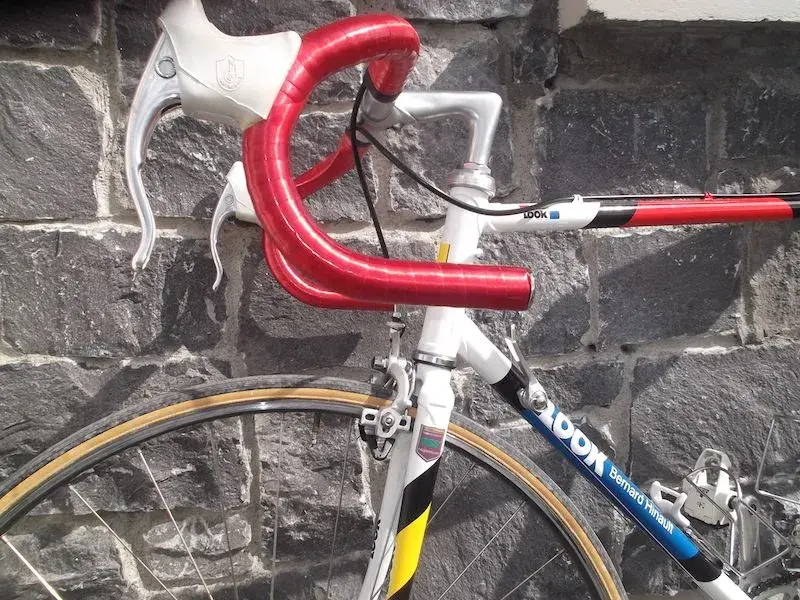

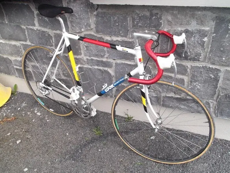

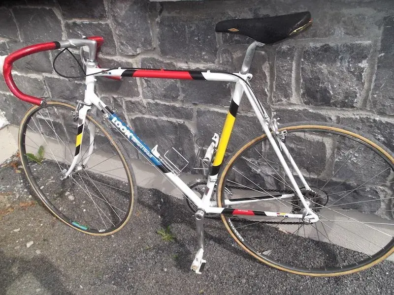

I saw one of the Look carbon fibre frames in the La Vie Claire colours a couple of years ago. I loved the paint scheme. The white pearlescent was lovely. I decided then to recreate one using a Raleigh 753 frame, it definitely was 753 tubing but the frame number did not begin with SB The braze ons were similar to alate 80's/early 90's bike. I removed the cable routing braze-ons and had three new ones put on the top tube. I also used a Rossin fork with the correct Cinelli fork crown instead of the 753 fork that came with the bike.
I sprayed it in the garage using 2k paint and used a metal flake in the clear coat to make it sparkle.

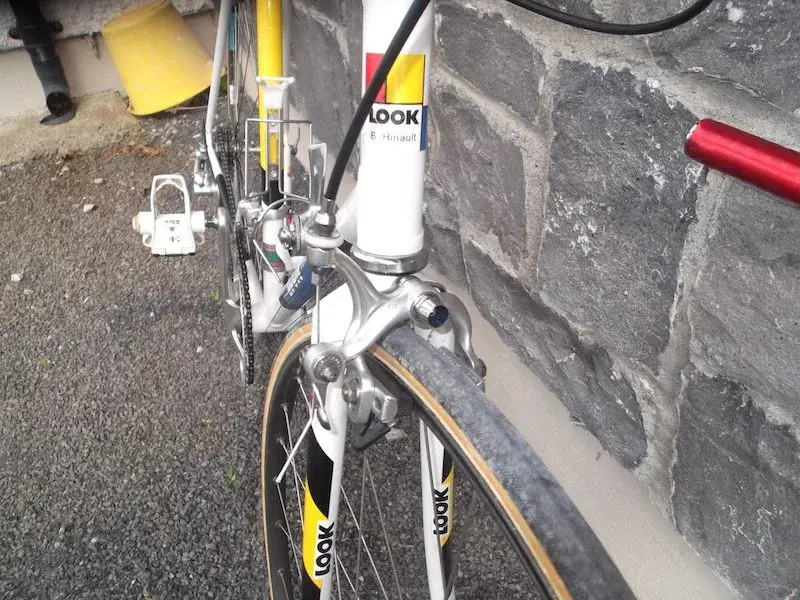

seat stays and rolls saddle, Brendan from the Bicycle Design Centre in Naas, Co. Kildare, Ireland put the top tube braze-ons for me.

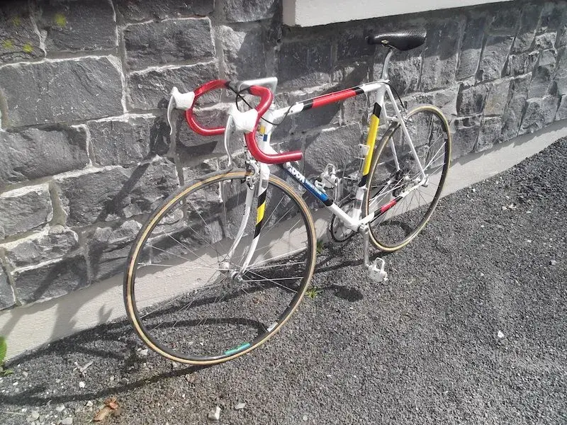

from the rear - the la vie claire decals are from Cyclomondo, the 753 decals are in french, I got them on ebay
