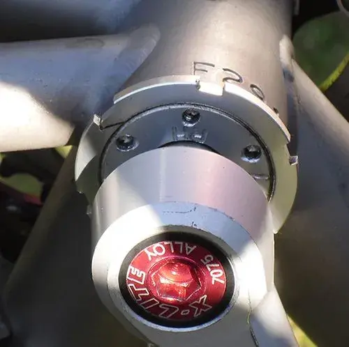

I seem to have snapped the lock ring(?) on my Hope bottom bracket (square taper, steel about 10 years old).
Can I get one of these from my local bike shop or do I need to order one from Hope themselves? Is it a common part that any LBS will have?
I also need the tool that tightens the lock ring AND the tool that tightens the bottom bracket itself. What are these called please?

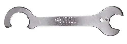

the tool you need is a lock ring spanner, or you could use a hammer and punch, if you're gentle with it...
