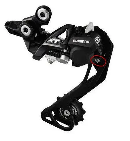

little grub screw on rear mechs...
twain
anyone know what this bit is called/where i can get one/what can i use as an equivalent if its not readily available??

Shimano call it a "plate stopper pin". My guess was "cage stop screw".
It's not listed as a spare part for your mech except as part of the outer cage assembly:
https://www.canyon.com/download/manuals ... 86_INT.pdf
but I think it's a fair bet that Shimano use the same M4 thread on all their cage assemblies, and your local bike shop is sure to have a mangled mech you can cannibalize.
https://www.paul-lange.de/index.php/de/ ... ungen.html
http://www.shimano.com/media/techdocs/c ... 609159.pdf
http://www.disraeligears.co.uk/Site/Shi ... 5_p18.html
Here's a pic. If it's good for you I can pop it in the post.

I've got to give it a shot! Looks about right but I've no idea how consistent Shimano are with their sizing of these parts across the models/years etc....
I'll pm you my details, thank you very much :)
