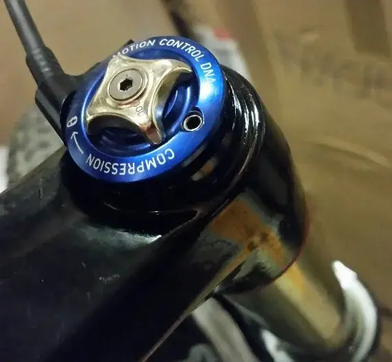

Despite being serviced recently, and with hardly any use since, I've spotted an oil leak on my forks.
Maybe I missed an o-ring when I serviced them? Which one though?
Oil seems to be coming from the top of the damper, perhaps the dial spindle but not 100% sure as I've not taken them apart yet, as I want to have the parts to fix when I do if possible.

Looking at the guide I'm guessing your fork has the motion control arrangement on page 49!
I'd just check that the seal on the top cap is installed correctly, not kinked or trapped in some way. Replacing it will surely cure your problem. BTW I've just posted about my own shock rebuild so now, obviously, qualify as an expert? It rode like a new bike today and it should be starting it's GCSEs this year!
Cheers, I recall replacing all the seals in the guide but I'll pop the top off and check them. I suspect the leak may be coming from the top of the damper, and there's a tiny o-ring not in the service guide that will probably need replacing.
