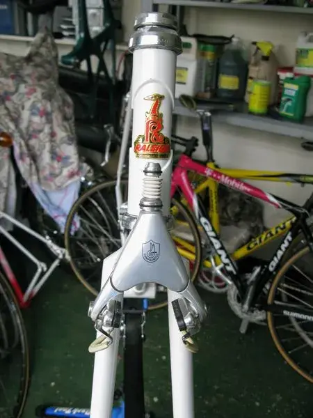

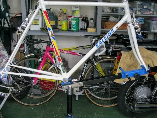

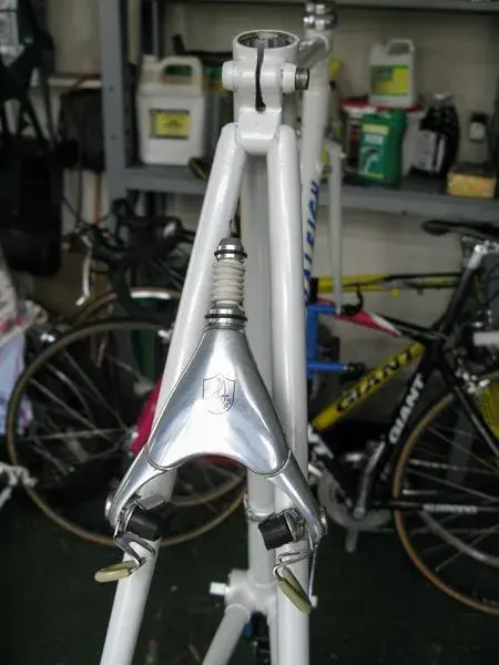

OK I've just had a Dyno-Tech XMT Metal Matrix frame arrive which I'm lead to believe is quite uncommon?
Its in Mint condition all white with a couple of the Raleigh Decals on the seat tube so I thought I would built up up as a Laurent Fignon 1989 replica bike with all C-Record parts.
The frame is 22 inches centre of the BB to top of the seat tube.
I've weighed the frame with out the headset or any parts fitted & its 1560 gms & the forks are 710gms
It's missing some decals on the Top tube & the forks & the existing ones are on top of the paint IE not under any lacquer so first question is where can I get some correct decals the thicker Vinyl ones that don't need to be under lacquer?
Next what make & model Handlebars & Stem did he use?
I'm more or less certain that the team used Wolber TX Profile 20mm Clincher Rims & 23mm Super HD Comp tyres.
Pedals I think were the white Time Equipe or Silver Mag ones. Which I already have NOS (I bought 10 pairs of them 5 years ago all NOS with Cleats & boxes)
A Rolls Saddle I think?
So please make an Old Man very happy & advise me if I'm wrong on any of the parts PLUS any help would be very much appreciated.
Thanks in advance for any help.
Chris
