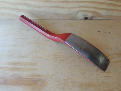

About 20 years ago the frame of this bike (and my right ankle) got trashed in an incident with my ex's horse. I claimed on the horse insurance policy and the bike was declared scrap by the local Kona dealer (Zoom Cycles in Lytham St Annes, UK). Under the "new for old" policy I got very a similar specced chromolly steel Trek 950. The Trek however was never as good to ride as the Kona so after a few hours with a heavy seat post sized bar and a planishing spoon I managed to bring the Kona's damaged frame back to reasonable shape and resurrected the old bike. From that point on, originality wasn't such a big deal but I didn't want to stray too far. Overall I'm quite pleased with the way the rebuild worked out. The barely used Trek hangs on my garage wall to this day. :D

What's a planishing spoon please? - no clear answer on google?
It's an old school tool that looks like a file with no teeth and smooth rounded edges. If used correctly it can (as Stringerfabrication says) be used to push dented sheet metal or tubes back into shape.
I've had one since my apprenticeship days as a Tinsmith/Coppersmith. Always knew it would come in handy at some point. :D

Before this gets out of control :roll: ...."body spoon" turned up a few results on Google
Hopefully you'll never need one. It takes a particular kind of stubborn to go to this extreme with an old bike frame.
