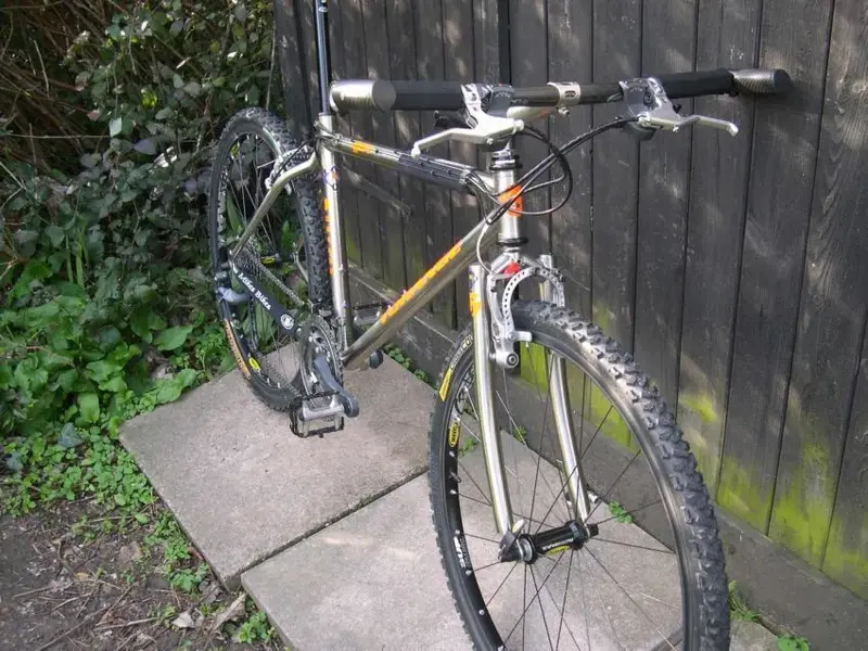

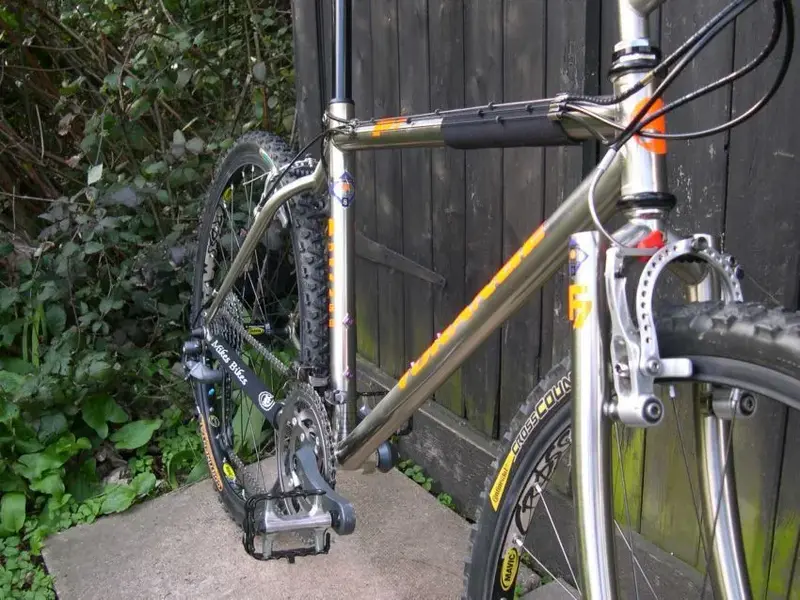

i basically gave up on my p7, its done no more than 100 miles, the nikel chipped so easy i stripped it, laqured it, rebuilt it, this is the last time it sore day light , 2 odd years back. i think the real reason i dont use it, ive out grown it,lol
