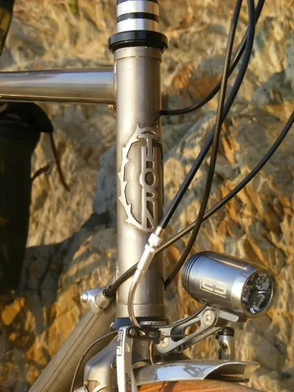

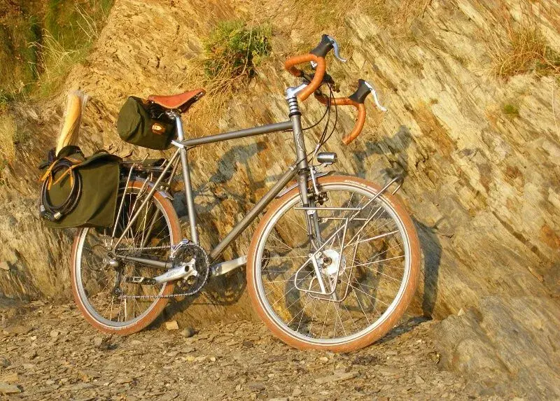

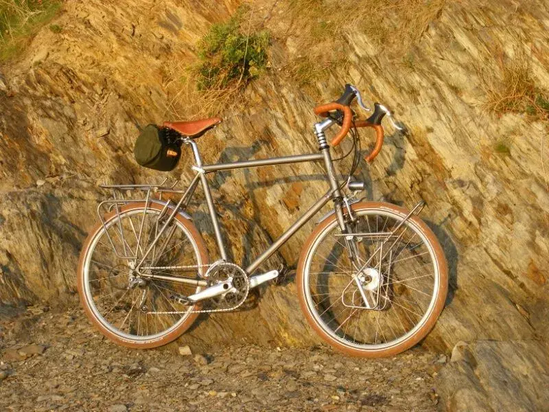

i did a Nos late 90's early 00's Thorn xTc classic bare metal frame with it, easy to use, awesome and i mean AWESOME finish like glass after wet sand and polish but it isn't very tough :cry:
it tends to chip easy also took weeks and weeks of curing to harden,
even then clamp it by the frame and it will come off, but it is easy to touch up
if theres any rust on the frame i'd use hammerite rust removing gel it cleans the rust really well and according to the tin it won't ruin any existing paint or lacquer
the xTc had a lot of surface rust as it had been in a box sat in a warehouse since it was (hand)made with no protective coating of any kind
i'll upload a couple of pics so you can see the finish after hammerite rust removal and halfords lacquer
steel is real, but raw steel is really something else :D
atb Bill
