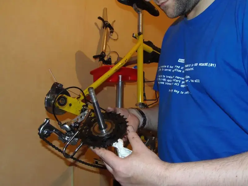

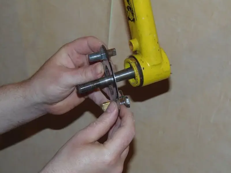

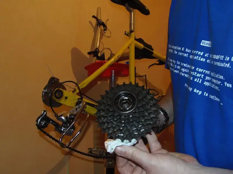

My chain tool also indicates that the chain is completely worn, which means I'll be getting a new chain and freewheel soon.
That's my chance to ditch all the Suntour parts and switch to Shimano, but it leaves me with another problem. Now I need to figure out how to get the freewheel assembly off the rear axle.
Normally you'd put a 4-pronged Suntour tool in a vice, put the entire wheel on top of that and turn the wheel. That's going to be difficult with this setup because that big bearing in the frame is actually a vital part of the wheel itself. I can't attach the wheel to the freewheel without that.
This job will probably require custom spacers and tools.
Bart, you have no idea how lucky you are to have gotten rid of that thing. It's giving me nightmares already.
Well, at least I now have a freewheel ... (switches to spanish accent) ... on a stick.
