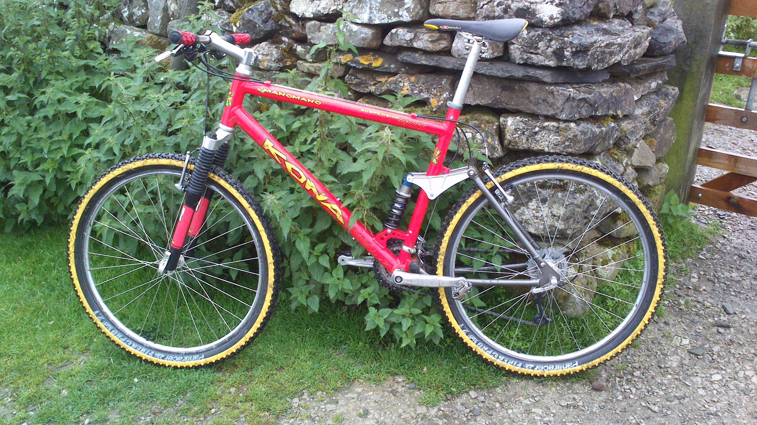

I'm approx 5'10" with 34" actual inside leg (not trouser)
I ride a nice comfy 20" 97 Explosif regularly.
It really is comfy.
The longer headtube gives for less dropbto the bars and while it half inch longer In the horizontal toptube than a 19", that distance to the bars being higher help.
I would say a 19" may be better if I was whipping it through a slalom of trees, but for my day to day riding on rough ground, peaks, dales, moors, local. It works well.
