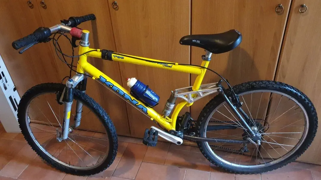

Kona sex too 1997 renovation

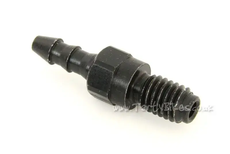

Magura hs11 ... I have no introducer for Magura Barbed Fitting.

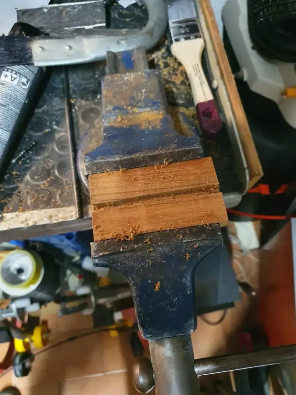

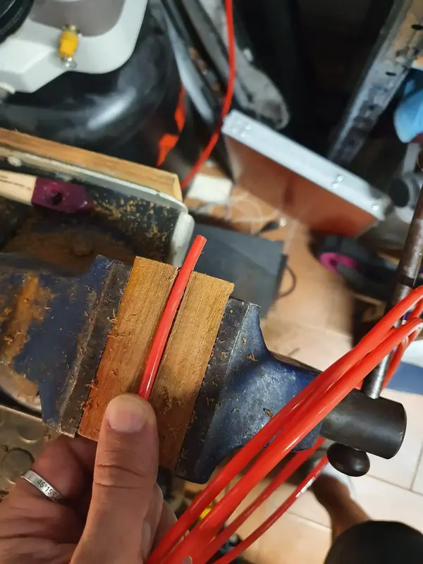

I created it with 2 grooved pieces of wood,

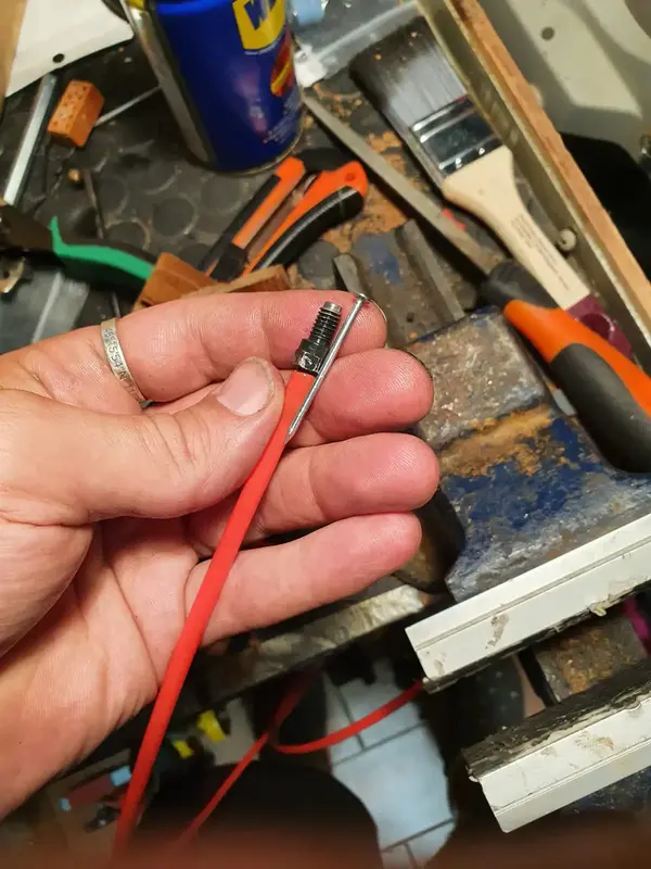

but I could not insert the barbed gasket as it bent the nylon tube even using the rubber hammer ..
so I helped myself to hold the gasket straight with a steel nail and hammer. iron (the head of the nail protected the gasket)

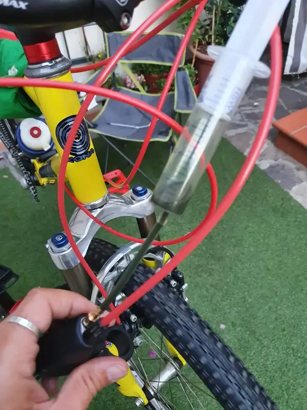

Now it remains only to purge the circuit

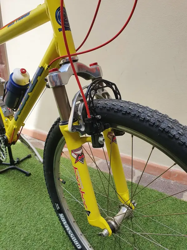

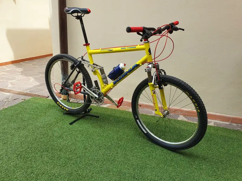

ladies and gentlemen ... I am pleased to announce that the restoration is finished !!!! yay!
thanks to everyone for the advice .... it was a pleasure to bring her to a second life !!
WhatsApp Image 2022-07-01 at 12.48.55.webp WhatsApp Image 2022-07-01 at 12.48.54.webp
