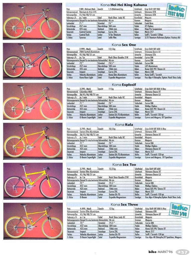

Notice the King Kahuna lists only the frame weight not the built weight...
And the parts are all in the spec.
Hei Hei was offered in 96 as a frameset and the parts indicates the factory kit which could be ordered as an option.

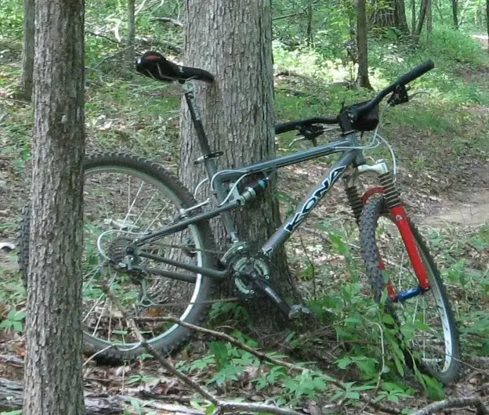

One original, one repainted.
