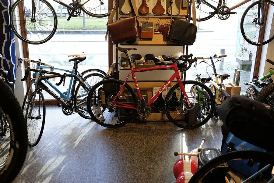

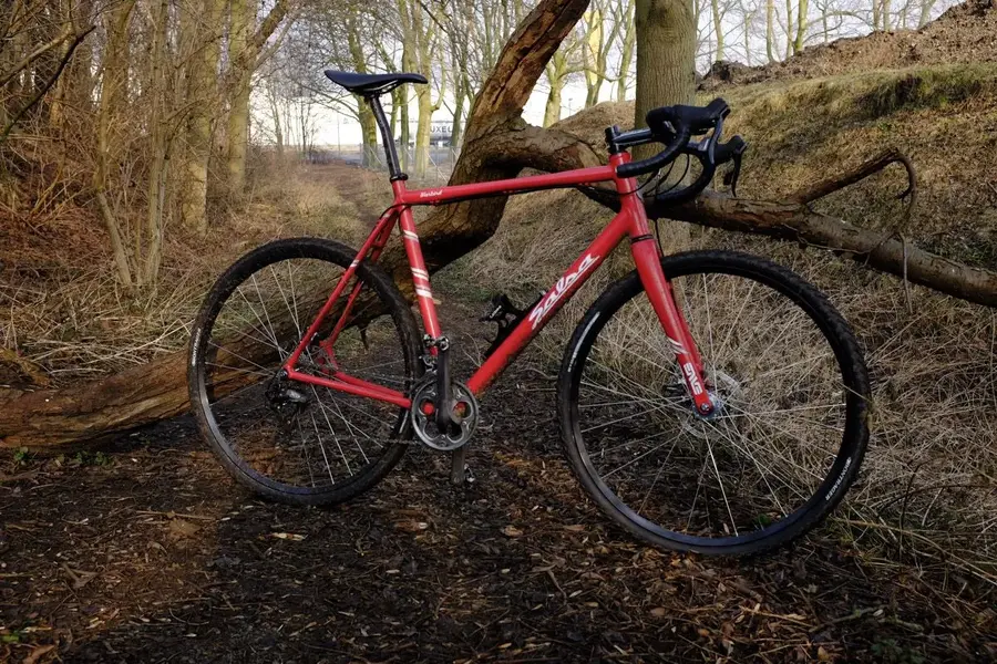

Not really. This is a boyish racer whereas the ti was a true gentlemen. however, I must admit. Salsa has got their bikes geometry pretty dialled!
Compared to the Kona Rove (59) the Warbird (58) sports a:
+lower BB
+shorter reach
+slacker seattube
+taller headtube
+shorter wheelbase
Other things I like are:
:) Reversed slot on seattube
:) full length housing
:) clutter less bb and down tube
Oh and that Enve CX fork is truly next level.
Too early for a ride review, but the build was pretty effortless & smooth.
What do you guys think? >>
Short ride review after 2 short (60KM) group/duo rides on the road and 1 long 150km solo off/on road.
First up: The Warbird is one of the raciest gravel racing bikes i've come to know of. I would even argue they perfected the genre well before it became a established market trend. The Warbird is better capable of reaching and maintaining speeds over 35 and 40km than my Ti Rove is. The handling is also quite a bit more neutral for a racer at heart like me. The cornering can be described as point and shoot which is quite a feat for a bike with longer wheelbase and longish rear. The overall wheelbase (on the 58) is 1,5 cm shorter than my rove (at 59) and the bottom bracket is 5mm lower too. Some people might not agree with this bike direct comparison because the warbird has no provisions for racks or even fenders and is arguably less of a touring rig and more of a self-supported big-distance big tire racer. The Ti rove for me was my first venture into off-road and ultra-endurance riding, after being a dedicated roadie for 8 years. I've since realised I wasn't to use it's touring capabilities and fatter than 40mm tires since part of my focus is still of long distance (multi) day trips. I've grown used to and love using removable bike packing equipment for these trips rather than taking racks and fenders on and off after every ride. Using a carbon fork (for weight and ride quality reasons) also limited this use anyways. I've been able to replicate the rather aggressive position (12cm saddle to bar drop) i'm used to and capable of maintaining for many hours. The alloy warbird that i'm riding is not noticeably different in vibration dampening compared to the Ti Kona. This proves the unscientific point i'd like to make that most of our ride quality is decided by our wheels and tires and secondly the construction of the frame rather than the frame material itself. Having said that the alloy Warbird is very smartly shaped with flattened sections on most of it's tubes. Off road the bike needs a little bit more riding input than the Rove to clear ruts and ride rough sections but it's equally capable of rocking the socks of many modest trails. On a final note I grown to love the full length cable housing on both brake and derailleurs. For clean looks they might have opted for internal routing but in terms of maintenance this is a huge improvement to the downtube routed partial housing used on the Rove. I must come at no surprise when I say that i'll be riding the warbird for a while to come. Even though I feel like I committed to the everlasting Ti with the Rove, I think the warbird is a near perfect match to my race inspired riding style and still allow for light touring and ultra-endurance events.

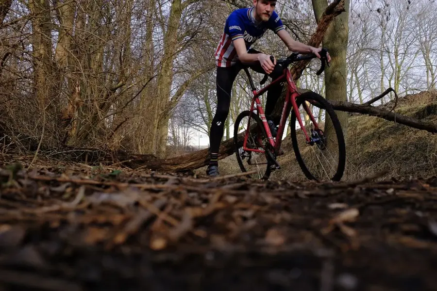

Another good test ride this weekend @ relaxing Kalmhoutse Heide
I'm wearing an original Roger de Vaeminck, Brooklyn Chewing Gun shirt (!)
which I received as a generous gift from a friend/customer!
