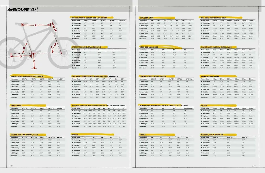

They seem to have stopped offering detailed information after 2003, but I do have this on the 2005 Kula Primo:
2005
MODEL KULA PRIMO (frame)
MATERIAL Scandium 7000
TOP TUBE 38X1.5/0.65/1.2t
SEAT TUBE 30.6/31.8X1.7/0.9/1.5t
POST 27.2mm
DOWN TUBE 50X1.5/0.8/1.3t
HT GUSSET YES
SEAT STAY 20.5X1.6/1.2t
CHAIN STAY 25.4X1.5/0.8/1.1t
DISC YES
CANTI YES
The other thing perhaps worth mentioning in case you weren't aware is that they did disclose (eventually) that although the Kula geometry (see below and apologies for the size) showed a head angle lower than in previous years, they hadn't actually made a change to the frames. They had previously quoted a 71 degree head angle, but they hadn't explained that they meant that it would have head angle of 71 if you fitted a 41cm a-c P2 fork. That was still the case in 2005, but they started quoting the head angle as it was with the fork the frame was actually sold with. The handling was still the same as back in the day because they fitted shorter stems to compensate for the lower angles resulting from fitting longer forks.

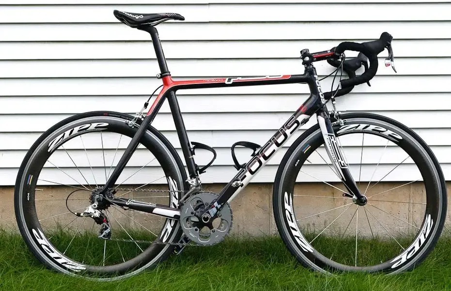

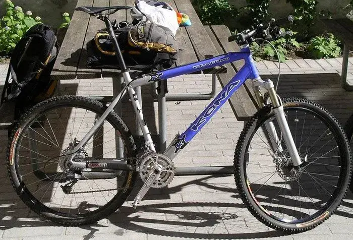

Its the same "issue" with my old Kula from 2001 (that I am now rebuilding!) and my existing roadbike. I have quite a drop from saddle to handlebar - gotta works the aerodynamics :)
