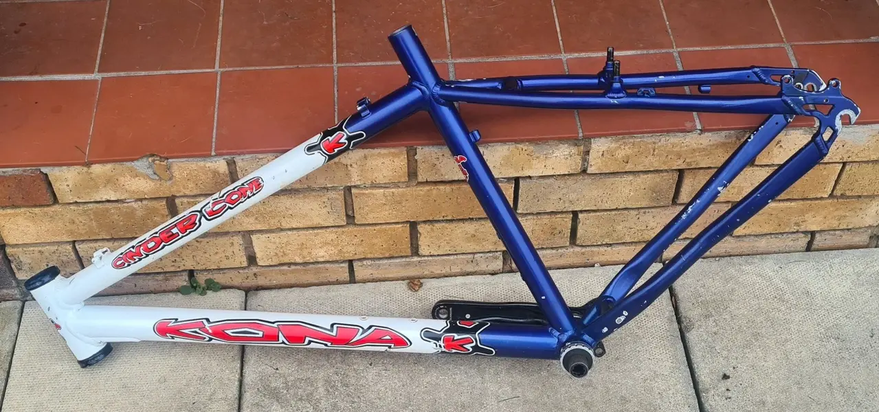

hi
I have bought this retro kona cindercone. I'd like to repaint the very chipped back end of the bike. the blue paint.
please could anyone advise me how to find the exact colour, so I can but that and match it.
many thanks
Lots of people use model paint or nail polish for touch ups
Take the frame along to a local automotive Paint supplier they should be able to help and should be able to mix up an aerosol or a small amount of paint for you if you have your own spray equipment .I use an airbrush when there is just a small amount to spray as I am able to fade the new into the old paint then lacquer it that way you don't see any small difference in colour.
thank you for the advice. I will take it to the car place nearby, they do paint spraying, so I will ask them to make some up for me.
