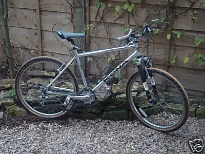

Bought this Kona Kula frame a couple of days ago and need your help with dating it. Frame numbers are: F712K1003 & 81-35 if that helps!

If it is a kula, it's easton tubed. my pahoehoe (same frame as kula) has the word "easton" stamped on one of the tubes somewhere (as far as i recall)... maybe top tube?
I'm only saying it may be a muni mula going from the colour of the decals in relation to the '98 catalogue and the fact there was no model sticker on top tube....
1999 was the first year that had that rear mech cable routing.
Not sure - my '98 Kila has rear mech cable routed down the seat-stay, though catalogue shows it running along the chain-stay.
So it's a Paho-Kula-Mula-Kila then :? First one of its kind and I thought they'd died out with the Dodo (or is that another Kona?).
Didn't see that Easton stamp when mucking about with it yesterday so will look again. Your right about those sticker colours though on the Mini-Mula!
I don't see any reason to doubt that it is a 1998 Muni Mula.
The serial number says it was built in Fairly in 1997, which is what you would expect of a 98 Muni Mula. The down tube decal looks original. I've never seen that cutout in the non-drive side dropout before. I don't think the 98 Kula had that.
Note the difference in the cable routing between these photos from the 98 catalogue and an actual 98 Muni Mula. As with all the photos in the 98 catalogue, the rear mech routing is shown on the down tube, but they made a change between then and the actual production bikes which had top tube routing.

Cheers for that. It does seem to be a Muni-Mula doesn't it ? Those down tube stickers did appear to be original but what happened to the top tube ones is anybody's guess!

That explains the 'cut-out' - an optical delusion. And at least you have a replaceable mech hanger, which the 97 frames lacked.
There's nothing much wrong with a Muni Mula frame. They used to sell them for £299. The specs compared to the Kula/Pahoehoe are as follows:
Custom butted 7005 aluminum tubing. Top - 35 x 1.6/1.3/1.6t, Down - 44 x 1.8/1.4/1.6t, Seat - 31.8 x 2.5/1.0/1.6t, Seat stays - 19 x 1.8t, Chain stays - 22 x 2.0t. 3.9 lbs (18")
Kula/Pahoehoe
Easton Elite tubing with 7005 aluminum custom butted stays. Top - 35 x 1.3/.9/1.3t, Down - 44.5 x 2.2/1.0/1.5t, Seat - 31.8 x 2.4/1.0/1.7t, Seatstays - 19 x 1.8t, Chain stays - 22 x 2.0t. 3.5 lbs (18")
Note identical stays. A Kula is definitely worth more though, so if you paid a Kula price you would be justified in asking for a reduction.
