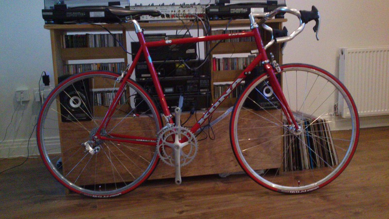

So yesterday afternoon it was polished up along with the cassette and skewer. With both boots on I think this really does look boss. It's just the final push now of cabling, tape, chain and tinker. Apologies for the phone pic quality:

That's a sweet looking bike.. I've just shelled out for a charge juicer just because I love skinny tubed frames.. tange prestige too :) but yeah I'm kinda jealous of your kapu.. maybe one day eh

She's all done minus a polish of the levers and pedals (and fitting them). Proper pic's will follow this weekend if it's dry. Apologies for the poor one here.
This bike is BOSS :mrgreen:
