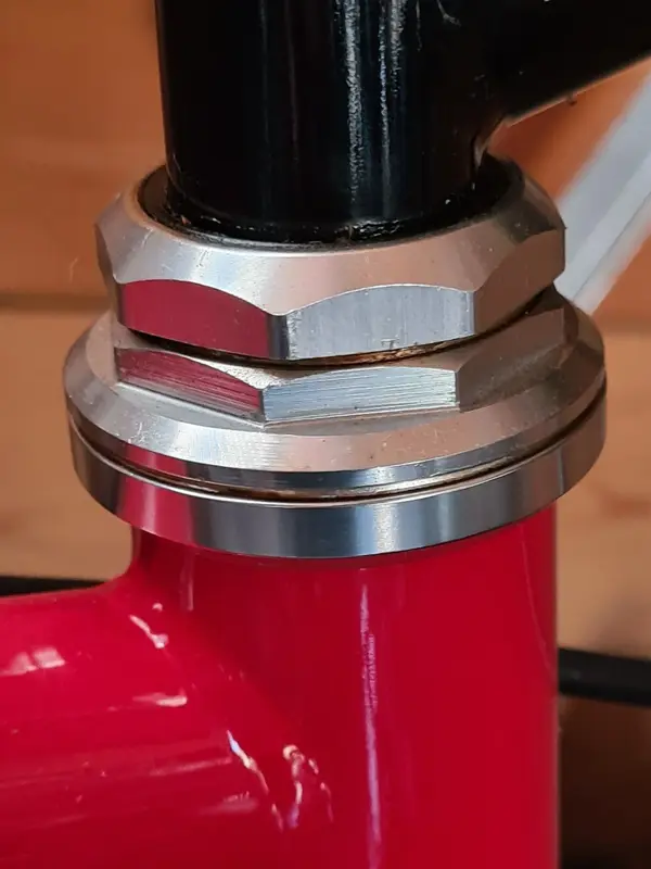

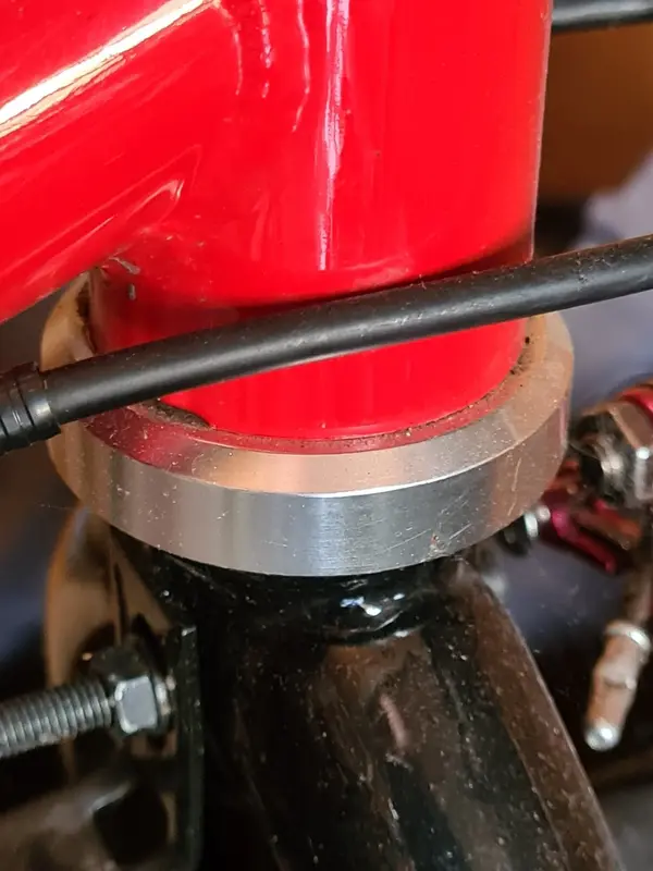

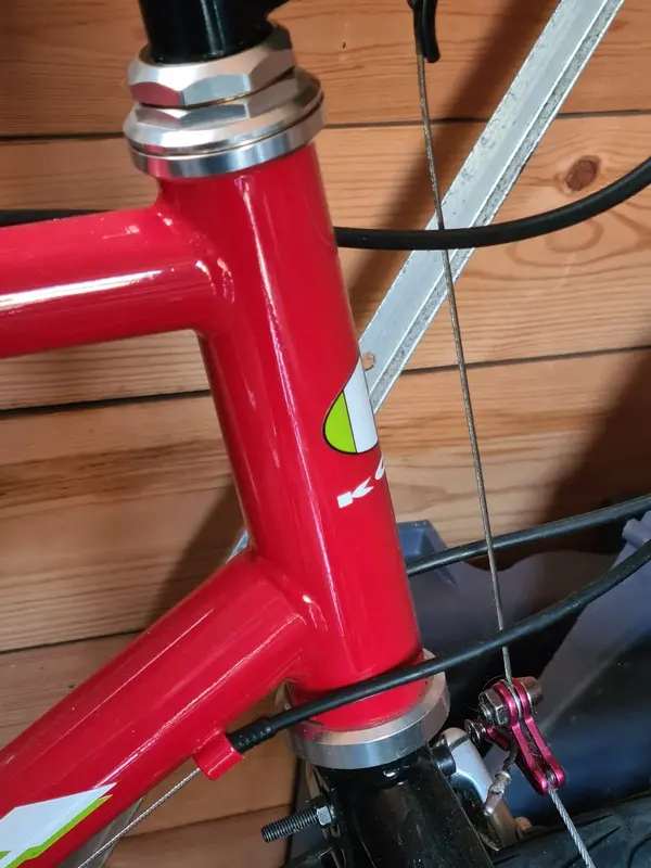

Yes, I do. I can post a photo if it helps. There was no problem with thread engagement. It is an alloy headset so needs fitting with a headset press, not a hammer and a block of wood.
Here you go. Looks like I even got the washer in between the locknut and adjustable race (not really a race; it's a cartridge headset) so stack height must have been perfect.
Tange say 34.5mm stack height.
Replacement cartridges are the same as Cane Creek (threaded or A-head), so easy to get if they ever wear out.
