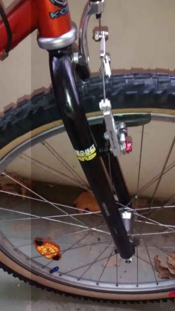

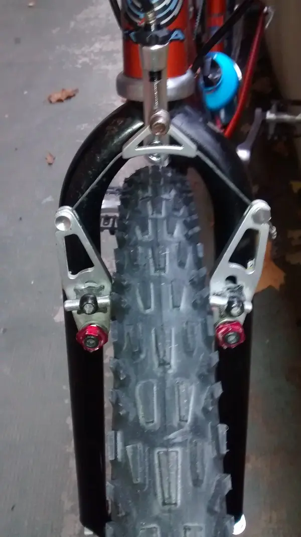

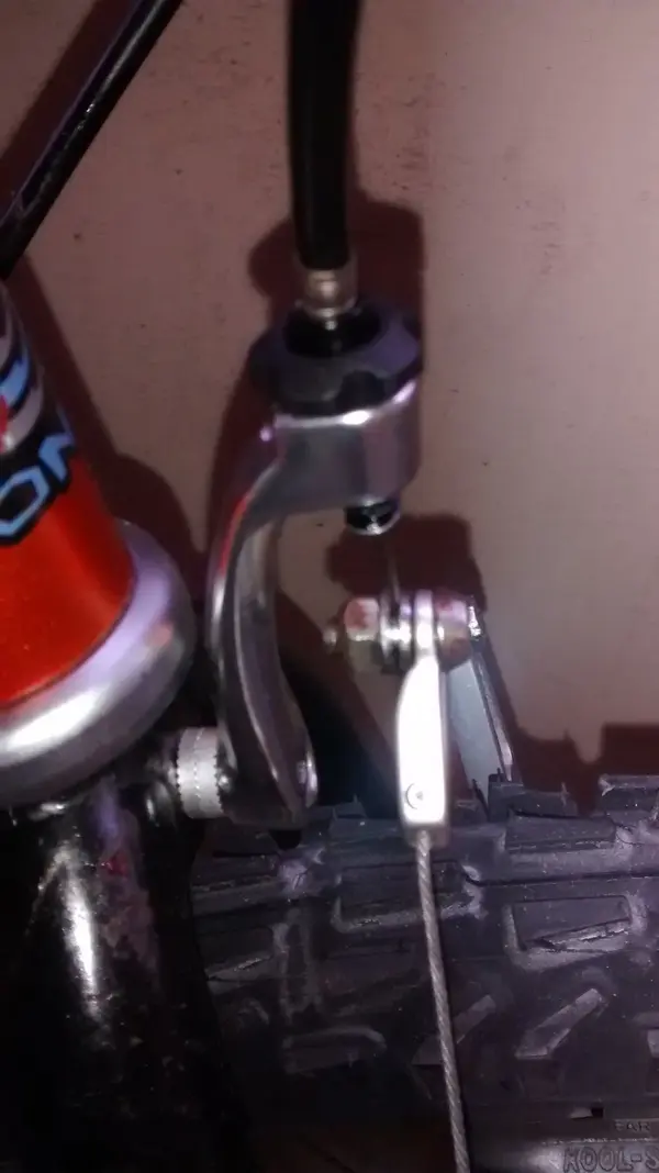

When the position of the brakes are the same at the left and at the right, that's good, there is the same tension in the two springs and when everything is connected, the brakes are evenly placed on each side of the rim. (I hope my explanations are clear, I have searched on the net, I have found nothing about that).

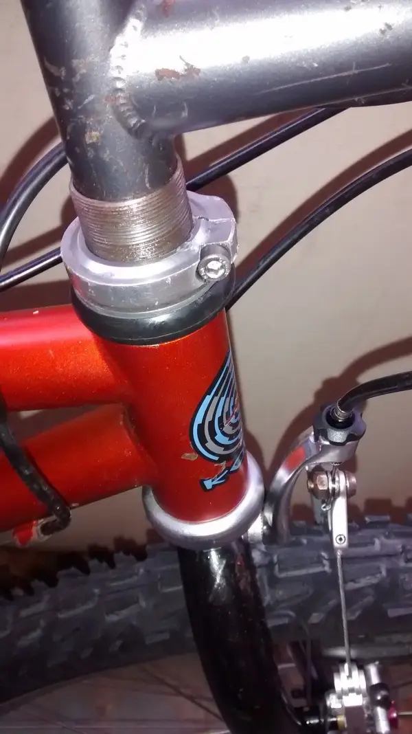

There is a fantastic tool to help you with that process. IMG_20221015_115801198.jpg it is called a Third Hand, uses spring tension to hold the brakes closed so you have two free hands to do the rest of the work. As for the Joe Murray era fork, it is a highly desirable piece, triple butted chromoly versus plain gauge. If it doesn't work with your headset (threaded vs threadless), you might be able to trade it with someone who has the newer version, and you could get some money in the deal...

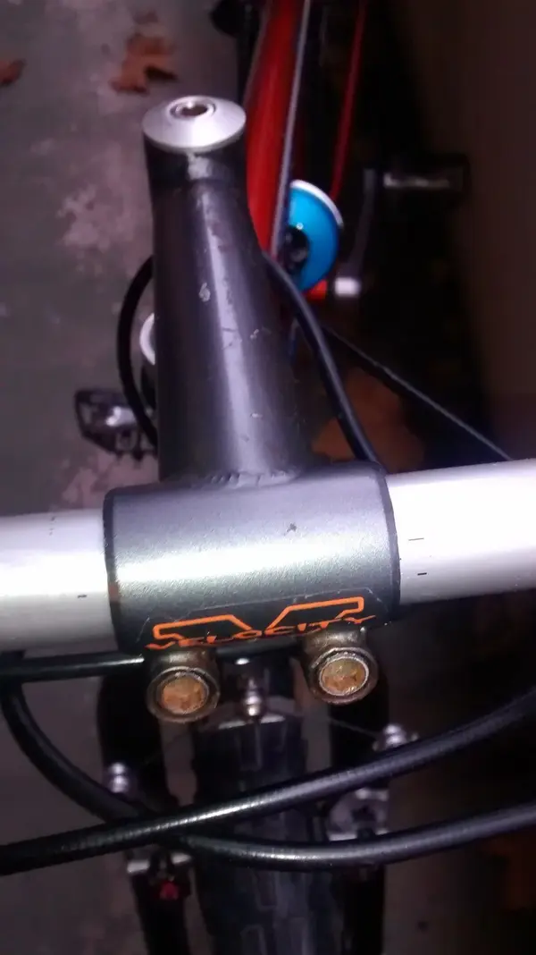

For the fork, the headset and the stem, the three pieces are compatible with each other. The only thing I didn't think of was the diameter of the handlebar. Its 22.2 mm, even in the center of it, and the stem is made for 25.4 mm handlebars. There is a "clamp" (let's use that name) I don't have (and it's understandable, because the stem that was used to replace the original one and that was adapted to the Rock Shox didn't need it (I don't have a photo of it, it's a GT one, very short, the same kind of stem we can find on the BMX).
On another thread about a 1995 Lava Dome, there is a pic where we can clearly see that clamp :
I'll see if I buy another complete handlebar (I've seen several ones on ebay) or if I can find the clamp alone (it's more difficult and I doubt I can find an original one).

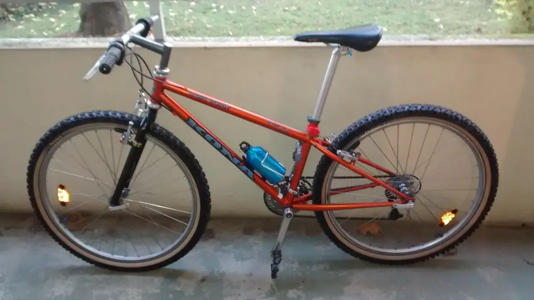

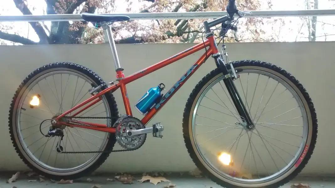

I quickly took a pic of the bike this morning (a little shaky). No finished, but that gives an idea :
The bike looks great with the new parts!
You can buy a 22.2 - 25.4 'shim' separate. There's quite a few on eBay from inexpensive Chinese options to cooler ones with longer end tapers like this black one:
Being a Kona Bar I'd be looking for a similar one with longer end tapers in silver to go with what they used BITD
Hello Canuckbiker,
I didn't know that this piece was named a shim. I did some research yesterday with other words and most of the time, I had results showing me seatpost adapters (presented like adapted to handlebars too - but I could see on the pics that it wasn't the good product, they weren't even symetrical). English isn't my native language and it's even more difficult if I don't know the name of the thing in my own language.
I did a new search with the "shim" word and I quickly found something perfect, in the same spirit compared to your example :
Guidon Shim 22.2 25.4 26.0 31.8 Réducteur-Convertir petite barre pour s'adapter à grande tige | eBay
(the translation is hilarious - "Convertir petite barre pour s'adapter à grande tige" ! 😂)
Of course, I choose the silver one (I don't have a choice as the others are not with the good dimensions).

I have received and installed the shim. Quick delivery and perfectly adapted to the stem (same width) ! The only thing I have to do now is to finish to install the headset.

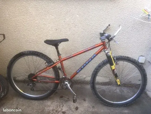

Strange thing : I have verified the weight of the bike and I'm at exactly 10 kg (22.05 pounds). When I bought the bike, the seller had used an illustration from Kona where the weight announced was 11,5 kg (25.4 pounds). And the bike is almost original. The most weight gained is, I think, with the seatpost (50 grams if i remember). The quick releases are probably a little lighter but the rest...
Do you know the weight of the original tyres (Scratch and Sniff if I remember well) ? The Dart is 590 grams and the Smoke is 610 grams. It's the only thing that can explain the difference (with the hanger, the fork is 750 grams or 950 ? I don't remember).
Hmmmm, another question : I suppose the frames are not the same weight depending on their dimensions. I'm not up at the moment for a complete disassembly. Does someone know what is the weight of the XS frame for the 1996 Lava Dome ? (I'd be curious to know the weight for the others too (S, M, L,...). On the catalog, there is only one weight mentionned (the one I wrote before, 11,5 kg).
W.

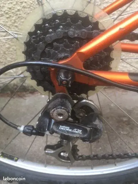

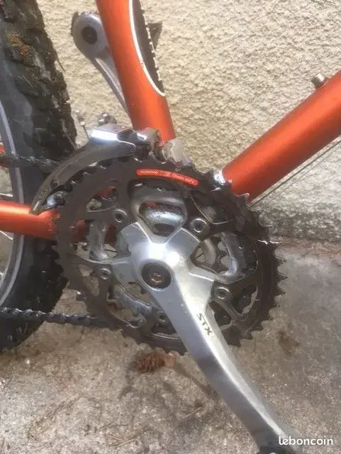

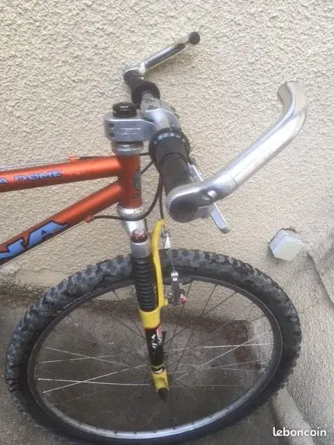

PS : the pics of the bike on the site where I bought it.

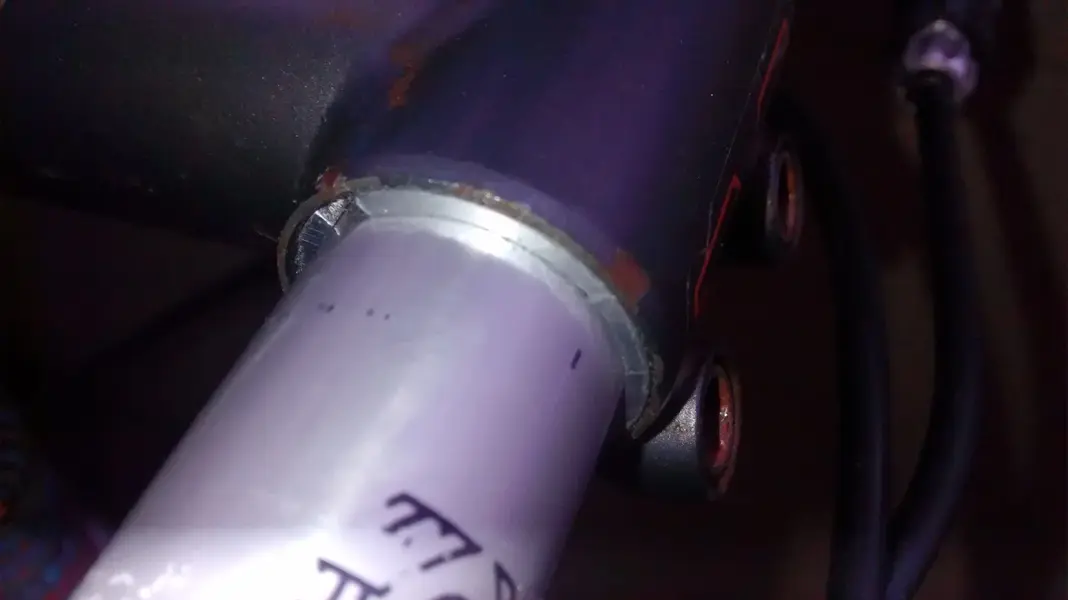

Hello,
I've received the tool to change my headset ! I could install everything (I only had done a temporary installation of the fork for now). Everything went smooth. I've taken some photos of the headset, the saddle, the fork, the cable hanger, the seatpost and, of course, the shim.
I'll put them in two posts as there are more than 10 pics.
The first ones :
The second part :
