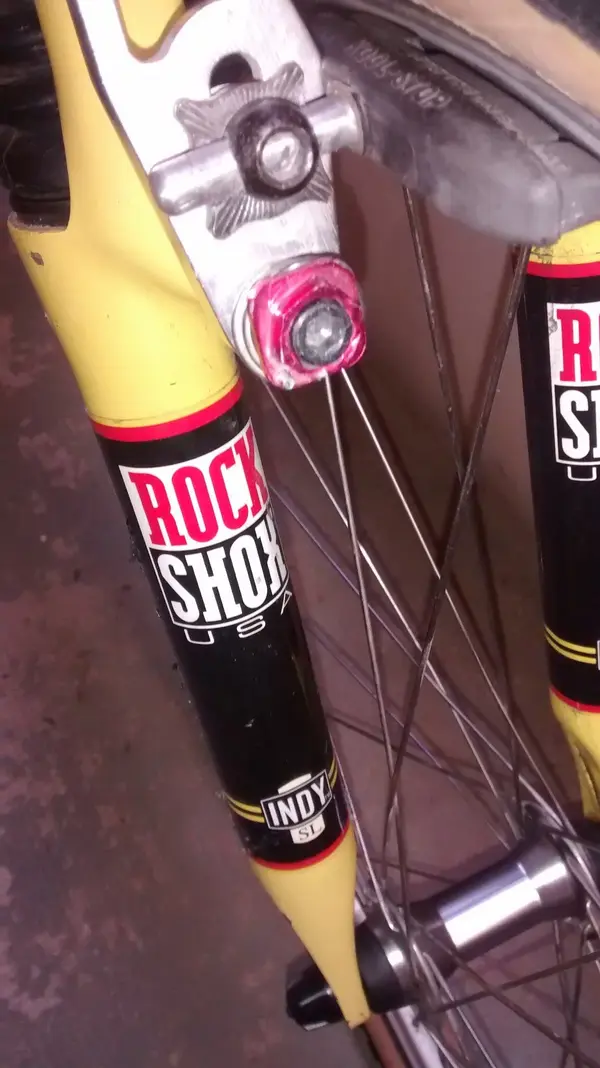

Forks are elusive here and I found a Project Two which is a Joe Murray one from 1990. From what I read, its length (the dropouts are 39 cm) is different (shorter) from the Project Two that was originally on the bike, but it's nonetheless a Project Two and it's way better that the Indy SL that is installed today on the bike (I have always hated suspended forks).

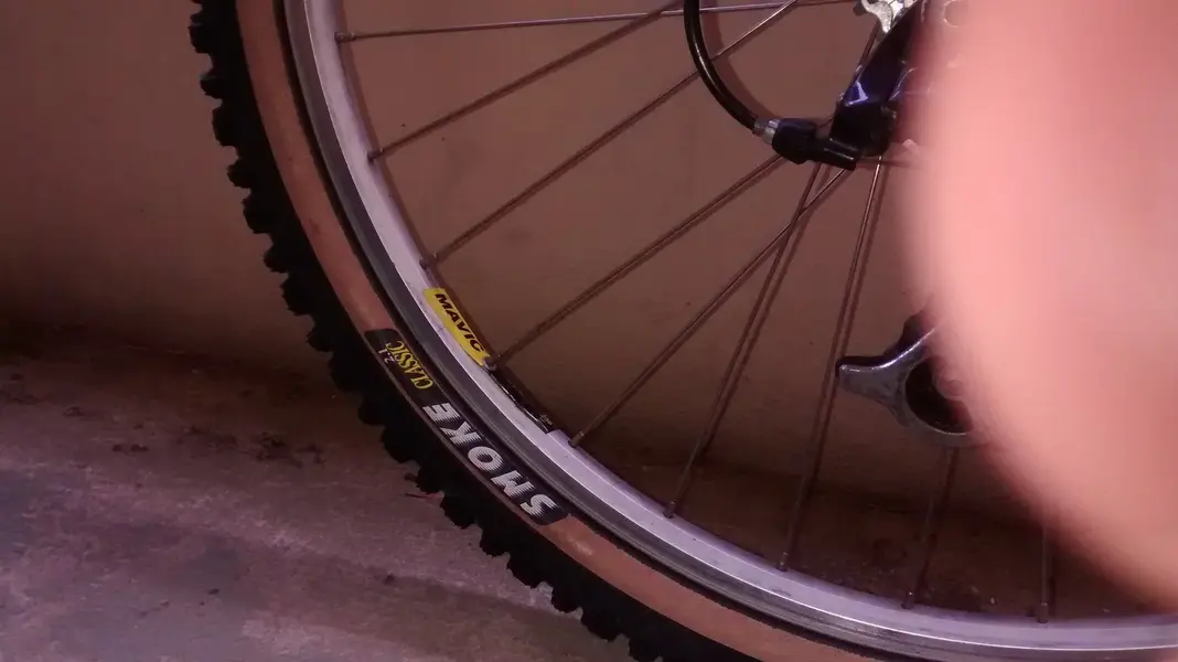

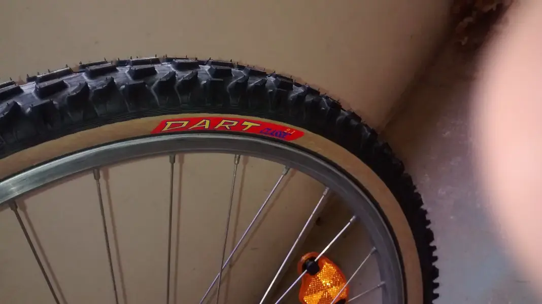

I like your Smoke/Dart tire choice, can’t go wrong there.

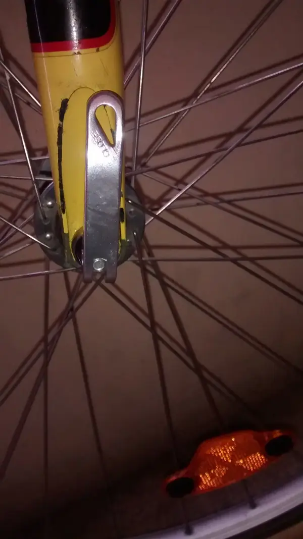

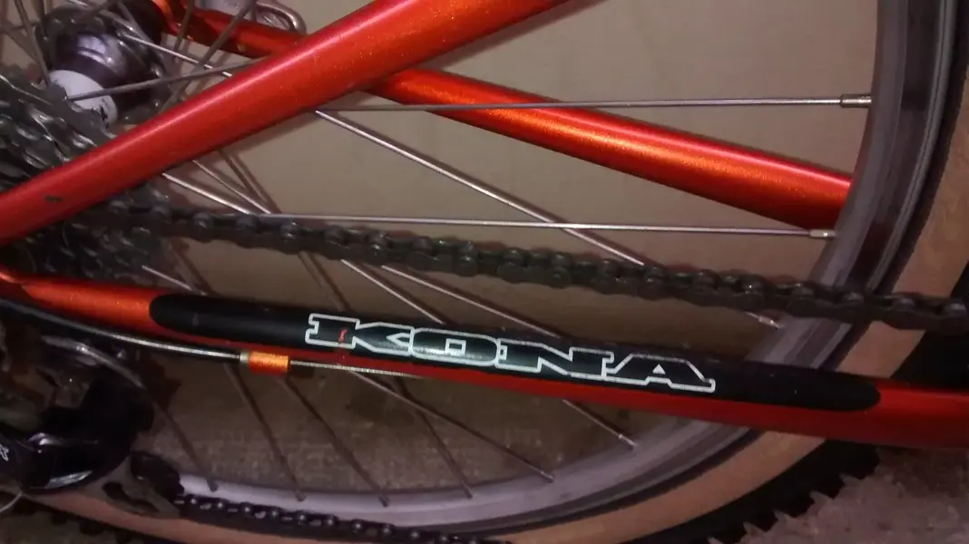

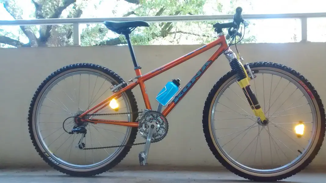

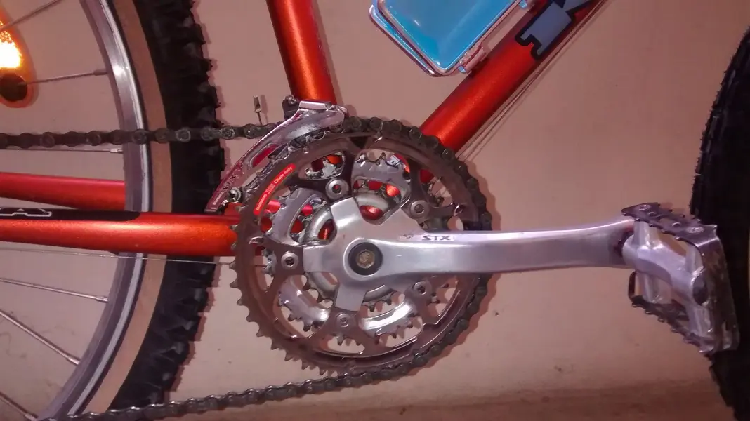

PS : and yes, I have some pics. The bike is obviouly not finished at the time, but here are some (beware, I'm not an accomplished photographer at all ! :D) :

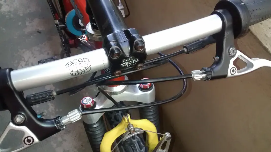

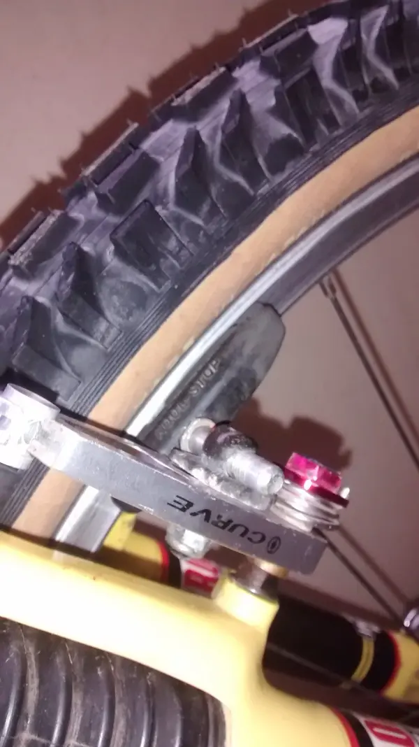

Yes ! :) The original brakes on this bike : Curve OM.
Very delicate to adjust but the braking power is nice (considering it's cantilever brakes, of course). When I got the bike, the front brakes weren't correctly adjusted. It took me almost 45 minutes to do something that isn't even perfectly centered (but braking is OK). I think I understood how to configure everything, but I was tired after all this time ! :D I hope everything will be fine after the assembly of the new fork. The new cable hanger will give me a little more room if I want to do something precise.
W.

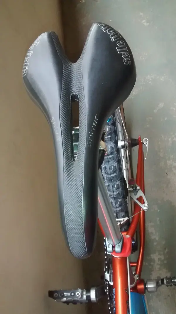

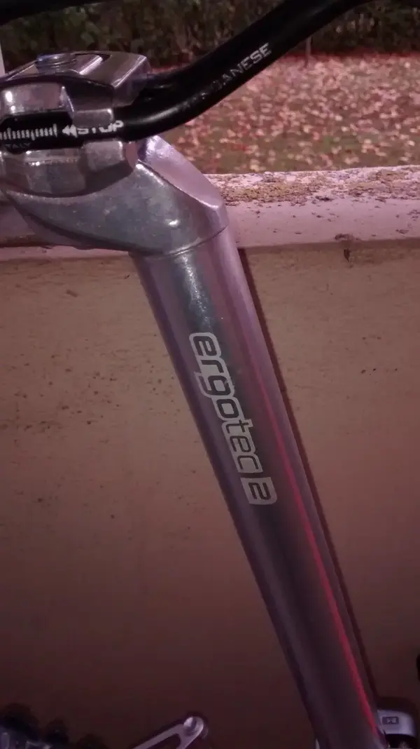

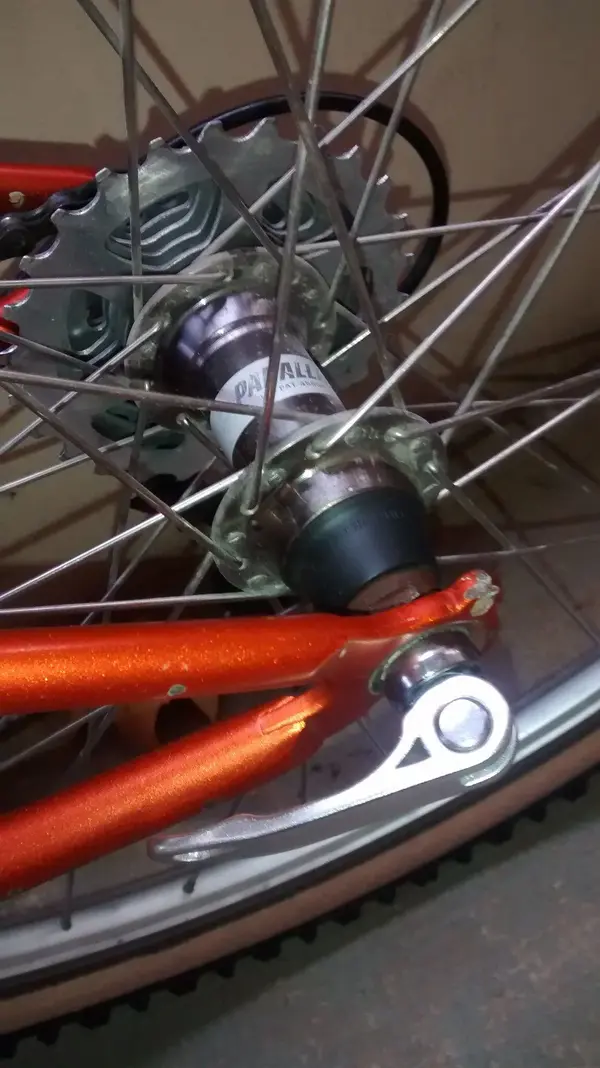

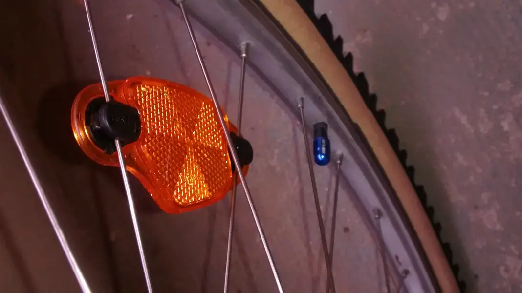

Other various details of the bike, with the new seatpost (Ergotec 2, 350×27mm and 300 g, aluminum), new aluminum bottle and valve caps (just accessories but a nice touch with appropriate colors). I still have the original quick releases, but they are not in great shape, I put generic ones for the moment. Waiting for the Expedia saddle, I installed a Selle Italia Shiver (my butt cheeks love it :D). Oh, and the teeth of the cassette were in very bad condition, I put another one from the same era I had lying around :

A thing I didn't see coming however : the handlebar is 22.2 mm everywhere, and the stem is made for 25.4 mm. It seems that there is a clamp (I can see that on various pics on ebay). I must find one (for the moment I use a band of rubber but is very far from perfect).
Another nice thing : I have understood how to configure the Curve OM brakes ! I said earlier that it had taken me 45 minutes to configure them the first time, but this time, it was done in approximatively 10 minutes ! If I try to explain : I install them by screwing the main screw. The first brake hangs out in a certain position. The goal is to have the same position with the other, on the other side. And for that, we must screw more or less the purple thingy. But on the right brake (when we stand in front of the bike), if we unscrew the purple thing, the main screw comes too. So, it's necessary to maintain it firmly screwed when configuring the purple thing. When the position of the brakes are the same at the left and at the right, that's good, there is the same tension in the two springs and when everything is connected, the brakes are evenly placed on each side of the rim. (I hope my explanations are clear, I have searched on the net, I have found nothing about that).
